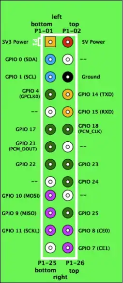

But not with PoE. The board can be powered using the GPIO. Here is a pin diagram showing the pins for power at the top.
Maximum permitted current draw from the 3v3 pin is 50mA.
Maximum permitted current draw from the 5v pin is the USB input current (usually 1A) minus any current draw from the rest of the board.
Model A: 1000mA - 500mA -> max power draw: 500mA
Model B: 1000mA - 700mA -> max power draw: 300mA

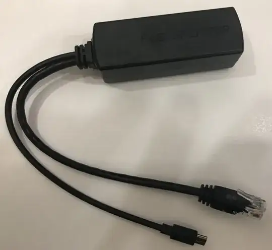

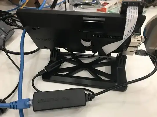

It is in fact possible to power the Pi via PoE using a PoE Splitter: £9.90 inc VAT from Amazon for the GB speed model. The data is piped through the Ethernet cable on the device and power from the switch is diverted to the MicroUSB cable attached to it which powers the Pi. So yes, can power the Pi via PoE, but via the standard Power socket on the Pi. You can also of course use a PoE Hat but if you need to use another hat, things start getting ugly ;-)

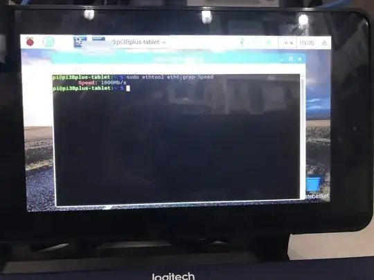

PoE Splitter The PoE Splitter is tested and known to work powering both a Pi and even a 7" LCD monitor as in below picture: PoE Splitter powering both a Pi 3B+ and 7" LCD display Picture of the setup working correctly from the front: Picture of the setup working correctly from the front
