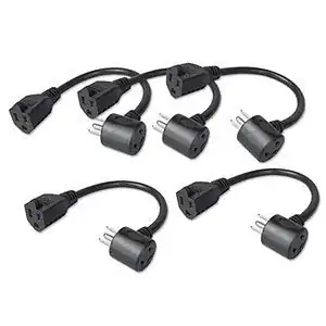

I bought something similar to this product at my local dollar store for $2:
The nice thing about these is that they have a pass through plug where it plugs in so you can plug in a normal plug right off the power bar, and then plug the wall wart into the extension part, so it doesn't interfere with other things being plugged in. Buy 2 or 3 and you can cheaply convert your regular power bar into one of those octopus power strips.
