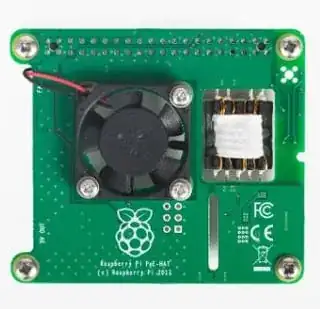

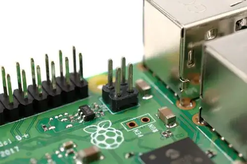

The Raspberry Pi 3 Model B+ (March 2018 blog announcement) and later devices support PoE with an official PoE HAT.
Unlike after market PoE HATs for models before the 3B+, the new PoE HAT uses the on-board Ethernet port, so you won't need you to plug your Ethernet cable into the HAT and then link the HAT back to the Raspberry Pi Ethernet port with another cable.

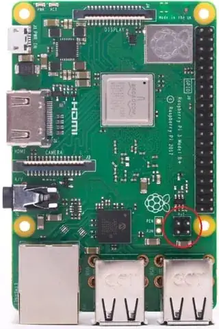

The PoE HAT does require a new 4-pin connector on the 3B+ board however, circled here:
Raspberry Pi 3B+ with PoE port highlighted Raspberry Pi 3B+ GPIO an PoE header pinouts
Although I could find no circuit diagram including the new Ethernet connector, the mechanical specifications for the Raspberry Pi 3B+ and PoE HATs have been published, and there is also a product page for the PoE HAT at CPC and also at farnell:

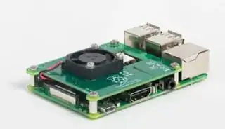

Raspberry Pi 3B+ PoE HAT top view Raspberry Pi 3B+ with PoE HAT installed
As suggested in the mechanical spec, the hole and cut-out to allow camera and display cable access.

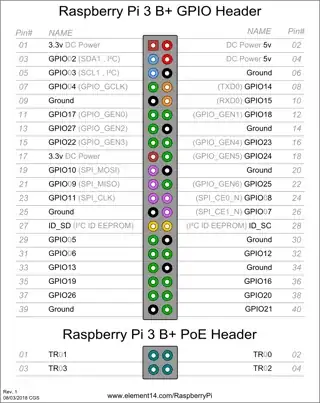

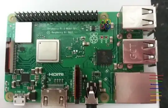

I have tested the POE connector with a multimeter, as I expected each pin on the POE header corresponds to a pair on the Ethernet connector. I include a picture below of the pin mapping I have determined.
Raspberry Pi 3B+ POE pair mapping

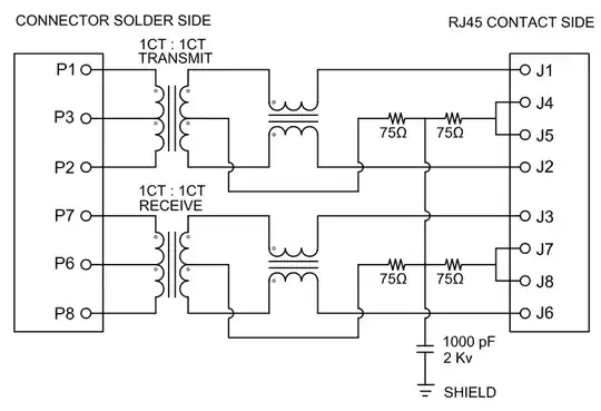

I will answer with the assumption that you want to have a solution that interfaces directly with the Raspberry Pi's ethernet connector.
First of all, the RPI uses a magjack, not merely an RJ-45 connector. The best I can tell from the B board, they use an EDAC A63-113-300P131 magjack.

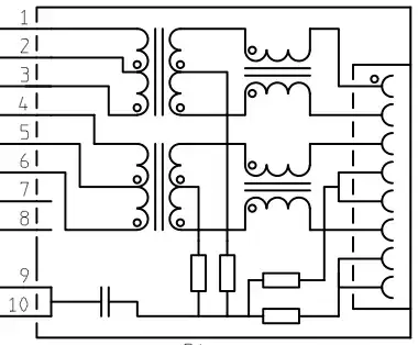

The manufacturer's schematic is below, followed by the connector symbol from RPI-B schematic, and the pinout. They agree, although the manufacturer and RPI folks number the pins differently.
EDAC magjack schematic magjack schematic from RPI-BEDAC magjack pinout, top-view
A compliant PoE solution needs access both to the primary winding center taps, and to RJ45 pins 4, 5, 7 and 8. Those are (of course!) not available outside the magjack in use.

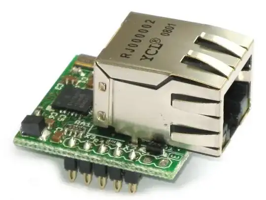

One hacky solution is to desolder the magjack, remove the 75 Ohm resistors, and bring out the center taps and the pins 4,5,7 and 8. There's at least one person who did just that, and wired it to the PEM1205 PoE module.

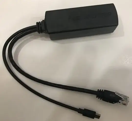

If you want to power your Pi via PoE, in addition to the PoE Hat answer by Mark Booth, you could use a PoE Splitter which means NO modifications are required to the Pi itself. Indeed, using a splitter means leaving the Pi free for a different hat unrelated to powering it. Also, the PoE Splitter is independent of the Pi and should work with any model of Pi. It just diverts power from the switch to a MicroUSB lead on the device and supplies it to the Pi's female MicroUSB port. PoE Splitter

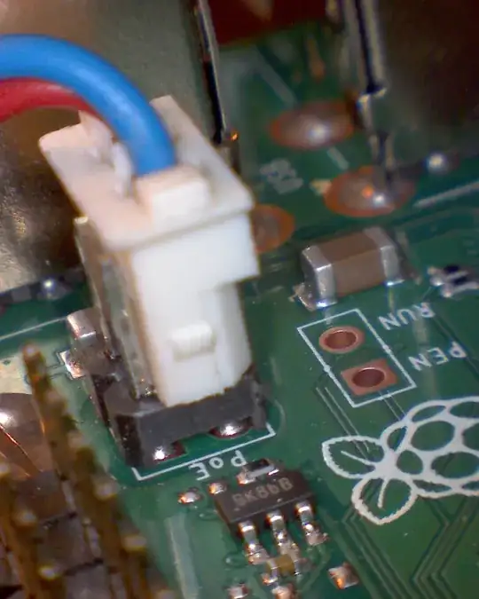

The Raspberry Pi 3B+ does not work with PoE wirings where two pairs are used for 10/100BaseT and two pairs are used for power. It needs all 8 wires connected.
However, if you have a proper 802.3af injector you can retrieve the injected power via the pins on the PoE connector.
I used a MikroTik GB PoE Adapter with a 24V supply, standard polarity (jacket-,core+). In my case minus came out to the pin next to the 'pen' marking and plus on the pin next to the 'run' marking (left front and right front respectively):
Rpi3 B+ PoE pins:
I connected these to a stepdown DC-DC converter (search for HW-636 on ebay).
tapping the PoE power:
