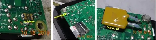

Replacing the blown polyfuse might be a solution.
polyfuse replacement
It took me 4 minutes to remove the old polyfuse, and another 2 minutes to replace a new one. I rebooted the Rpi and found everything OK.
Now I am going to measure the self heal time of the Rpi3B+ polyfuse.
rpi polyfuse

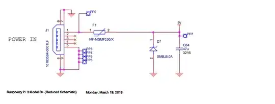

(1) Firstly, let us take a look at the circuit and do a postmortem.
rpi3b psu
(2) You see, only two wires are connected to the micro USB connector. So troubleshooting should be dead easy.
(a) Use a multi-meter to do open-short tests, check continuity of J1 pin1, pin5 to pp2, pp3,pp7 etc.
(b) See if F1, D7, C84 (47uF) are still alive.

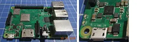

(3) Checking out the real thing

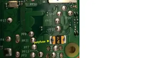

Now I am checking out the real thing: a broken Rpi3B+ with two GPIO pins already fried, but power circuit still working. I think the big black guy next to the micro USB connector, labelled KE 7J677 (pp7 test points at the back side of PCB, pp2, pp3 near by) should be the 47u cap.

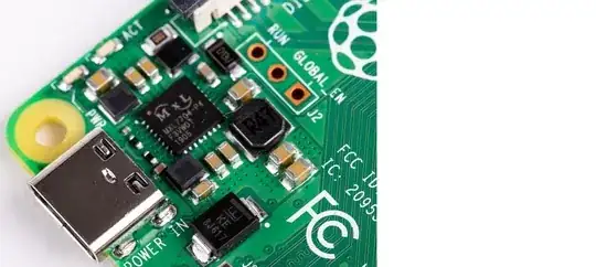

Update 2020apr26hkt1205
Rpi4B has a similar component (see the bigger photo below)
rpi3 psu
rpi4b regulator

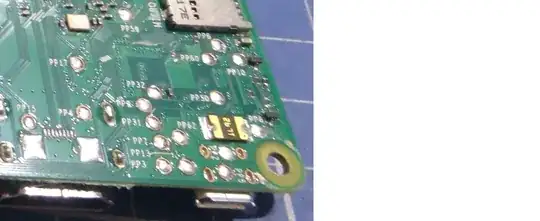

(3) Checking out the Test Points
I found the test points at the back side of PCB easy to locate and therefore the components easy to be identified. The critical components though SMD are pretty large in size, therefore newbie friendly to mess around.
Actually, you don't need to do the dirty job on spot, because you can extract two power wires out of the Rpi PCB and set up your "off site" test rig, say 10 cm from Rpi.
It would be nice if the polyfse, Zener, etc are blown off and become open circuit, effectively isolated from the to be replaced components. And even the old/broken components stay in place, new components can join in parallel, sort of good and bad guys working hand in hand.
Of course I don't guarantee that nothing won't explode. But your broken Rpi will sooner or later goes to the dust/trash bin/can anyway, you have nothing to lose, but only gain in "advanced" polyfuse and Zener circuit theory and practice (yes, OK, hacker practice/tricks).
Anyway, the Rpi power circuit seems easy to hack. So, without further due, So let us start messing around, ... :)
psu back side pcb

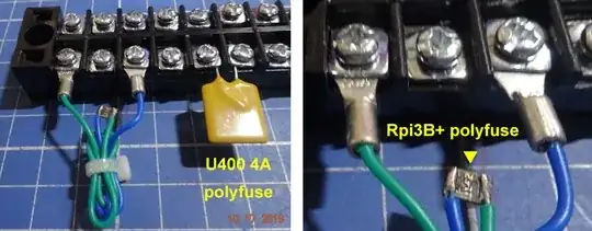

(5) Replacing blown out Rpi SMD polyfuse by through hole polyfuse
Actually it is dead easy to locate the poly fuse: it is the big and rich rectangular guy with 24k gold hat and shoes, as shown below. To confirm, I used a multi-meter to measure the resistance and found it very very low resistance, both direction, as low as pure gold! (definitely not Zener or 47 uF capacitor, which have different bipolar resistance values) Now I am going to remove it and do some experiments to verify that my guesses are correct! :)
polyfuse
/ to continue, ...
