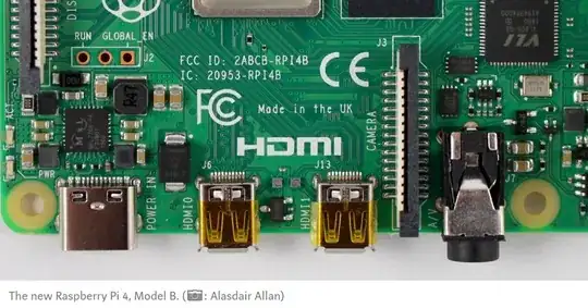

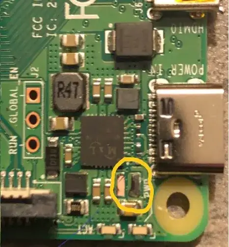

I broke what looks to be either a diode, capacitor or resistor on the board near the power connector of the pi 4B and I want to try to replace the surface mounted component. I know the chances are pretty slim, but I cannot try without knowing what I need to get.
From other questions, I have included a picture showing the board around the missing part:
Busted part

Well, I found the answer to what part is this by writing the Raspberry PI Foundation. The part number is Bourns SRN2512-R47M - Fixed Inductor 470 nH 4.4A 32 MOHM. I can get it for 31 cents but I figure wrapping about 7 turns of 22 gauge wire around a 5/16" drill for 1/4 inch coil length will work the same.
I asked around and it seems that Broadcomm is very secretive about their boards, so no parts layout (even on the board itself) and this percolates all the way up the RPF stack.

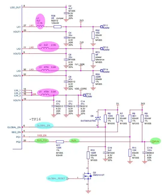

I read the schematic and found 4 chokes. Perhaps it is one of the bigger ones.
You might use a multi-meter to check if they are connected to the big flat black guy.
Perhaps no choke can still work, only that connected output voltage not that stable. So one quick and dirty solution is to short circuit the broken choke.

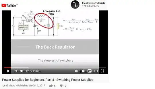

I called the black guy a choke and not an inductor, because not too long ago I guessed something inside a wall wart an inductor for making a switching power supply's oscillator, but then found it called a choke. I guess it is like the choke used in home white neon lights in those were the days. The purpose is to choke down the current so no excess flowing. But then I remember that R-L-C things can be used as low pass filters, to stablize output voltage of a switching power supply, of order of 100kHz. In other words, to make the output clean.
I usually go to Electronics Tutorials to refresh my memory and to verify. And below is something perhaps useful. I am too lazy to watch the youTubes. Perhaps the OP can watch the movies, and let me know if my suggestion is too risky and indeed something might explode.
Of course to play safe, I would suggest the following: (1) Use a multi-meter to check the point is question is a DC voltage. (2) Use a 10k to replace the choke, and see if Rpi is working again, (3) Invest money or time to find a similar valued choke (no need SMD, just a through hole one can do, to show off to friends that he knows how to "improve" the Rpi! :), and try his luck again.

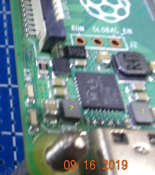

Now let us take a close look of the big guy MXL7704.
mxl7704

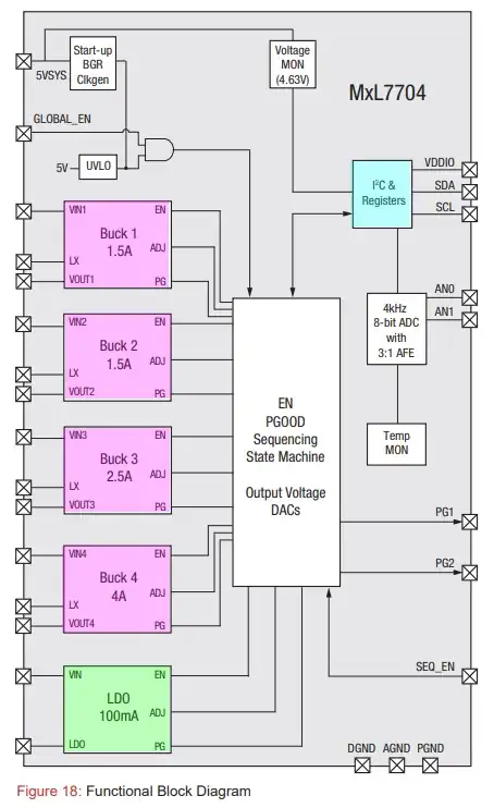

I suspect MXL7704 has all LDOs inside. In other words, there is very little chance of using the external inductors for it internal switching PSUs. A recent discussion by another OP on CM3 PSU design (Ref 7) gives more details.
I think perhaps I can study MXL7704 inside to see if my guesses makes any sense.
Update 2019sep16hkt2158
I read MXL7704 datahseet (Ref 11) and found it has 4 bucks and 1 LDOs. So I think my guess should be 80% chance correct - the inductor are only for low pass filtering, so should be no harm short circuiting it. Again, no guarantee no nothing will explode! :)
