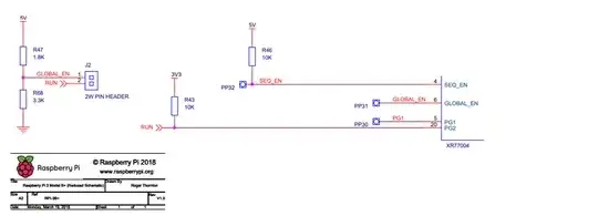

I'm trying to power on a RPi 4 using the RUN pin. The RPi is runing LibreELEC (Leia) 9.2 ALPHA1. I tried shutting down the RPi from LibreELEC's GUI, then grounding the RUN pin for a second by connecting it to the pin next to it, but nothing happens, the RPi doesn't boot. Previous models of the board could be powered on this way, did something change?
I should add that the board correctly resets when it's powered on. I just can't power it on when it's in a halted state, which I expect from a reset pin.
When looking at the schematics, I don't think I'm doing anything wrong.
RPi4 RUN and GLOBAL_EN pins schematics

The RUN pin on the J2 header of the Pi4B is shown on the schematic as connected to the PG2 pin of the MxL7704 power management chip (which AFAIK is an open drain output). This is, in turn, connected to the SOC RUN line, so still should be able RESET the SOC, but I have not yet tested this.
The GLOBAL_EN pin is connected to the MxL7704 power management chip, and pulling this low should be similar to cycling power. I would expect that it would need to be pulled LOW for a few seconds, to give capacitors time to discharge.
Checking with hardware people, on Pi4 shorting GLOBAL_EN to ground will reset a Pi4 from halted state
I think that RUN_PG2 line is output not input line. According to MxL7704 PMIC datasheet, it informs outer systems, that power is good. So, there is no result on grounding it. But applying voltage to it, may be dangerous.
GLOBAL_EN is the right input to switch off power in correct seq (not to shutdown OS). You can switch off power completely (including 5V, 3.3V GPIO) by grounding this input. Once released PMIC chip start power up sequence, which results in OS boot.
So, GLOBAL_EN is 'hard reset'. OS should boot on releasing it from GND. Marek

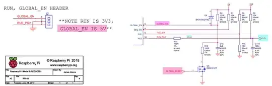

There seems to be another pin called "Global Reset" connecting to a N channel MOSFET, with a gate threshold 1V. Should this pin set High to reset Rpi? It is a bit weird to have left the gate pin floating. Perhaps I have forgotten the MOSFET theory of operation! :)
rpi4 reset
Update 2019jun03hkt1306
I found Rpi4B reset circuit different from Rpi3B+. Perhaps that is the cause of confusion! rpi3b+ reset cct
DMG1012T N-CHANNEL ENHANCEMENT MODE MOSFET - Diodes
