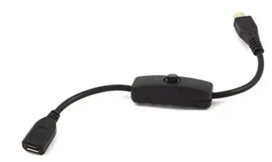

You can buy these USB power switches for Rpi 1 to 3 and a USB-C type for Rpi4. I have one on each of my Pis. Around 3 to 5 UK pounds or equivalent. They often have an LED to show when power is on.

To avoid having to fiddle the USB plug out of the Pi each time you want to reboot it or switch it off, you can also unplug the power adapter. This is far less likely to cause any damage. Alternatively, buy an extension cord with a switch to power the Pi. I use one that shuts off all my lab equipment from mains at once.
