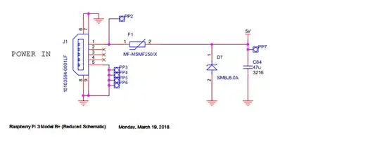

The Pi3 has a 2.5A polyfuse. It will ""blow" if you pull more than 2.5A from the power supply. If you keep overloading it the fuse will eventually fail.

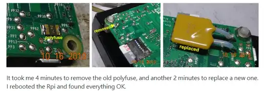

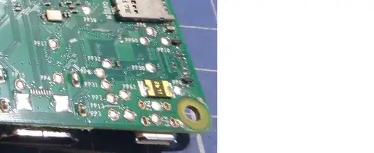

Yes, and if it is blown, you can replace it.
replace polyfuse
(1) If Rpi3B's polyfuse is blown, Can I save it?

Appendix A - Rpi Polyfuse Schematic
polyfuse schematic
