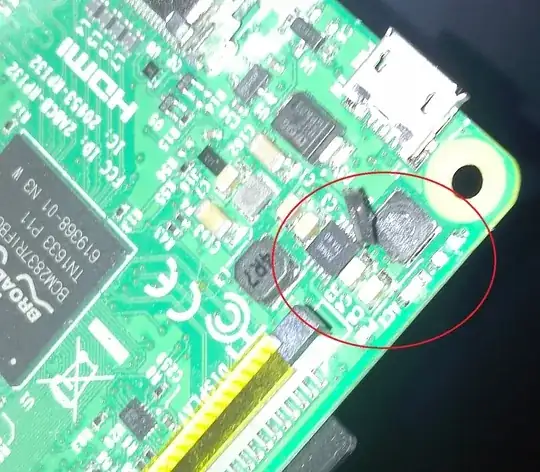

I was toying around with the Pi, left it in a place where I should have not put it, and it fell to the ground. I picked it up again and noticed one of the small "4R7" labeled boxes was kind of busted (in a 90 degree angle with the board).
I've tried to plug it on and is not working. No lights, no boot, nothing. It seems everything is pointing towards the Pi being dead. Am I right?
EDIT: This is how it looks:

That looks like one of the inductors - if you get yourself a schematic there are two - L1 and L2 that are 4.7uH, both used to provide the internal voltage rails, 3.3V and 1.8V from the 5V supply so unless you are able to refit a new one I afraid that it is probably broken.
