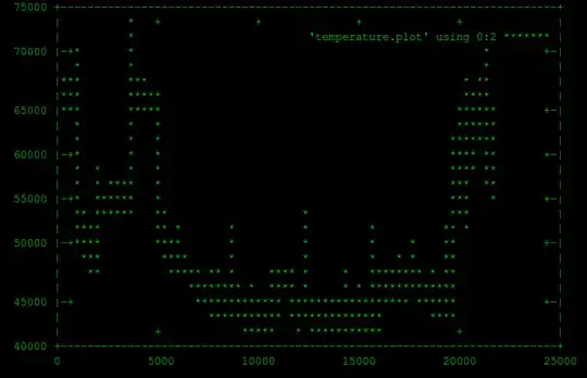

The following is a little outside of the question, but a general use case that might give some ideas.
This can be adapted to any kinds of inputs, gpio sensors, internet datas.
How to graph the CPU temperature overtime?
Install gnuplot
Gnuplot can graph datas in the terminal, does not require any X server and use very little ressources.
It works smooth even on the slowest raspberry pi's model 1/zero.
sudo apt install gnuplot
Script example to build a gnuplot file:
temperature script to store the data overtime.
#!/bin/sh
echo $(date +%s ; cat /sys/class/thermal/thermal_zone0/temp) | tee >> temperature.plot
Give execution rights to this script:
chmod +x temperature
Detach and run in 1s loop till next reboot:
nohup watch ./temperature &
Later, graph the datas:
gnuplot -e "set terminal dumb $(tput cols) $(tput lines);plot 'temperature.plot' using 0:2 with lines"
gnuplot temperature
This is a barebone example, temperature in Celsius * 1000, and seconds since the start, to be extended in your own scripts suite.
To kill the watch loop, killall watch
Happy hacking ;)
