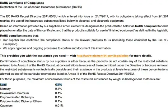

You are correct, there is no proper specification about this camera and the only source might have been the ROHS certificate. In 2006 EU prohibided the use of solder in all general use appliances, except capacitors. *As of point two in the wheras directives. So to be ROHS certified they must have used Lead Free Solder
popular lead-free solder alloy family is based on the reduced melting point of the Sn-Ag-Cu ternary eutectic behavior (217 ˚C)
