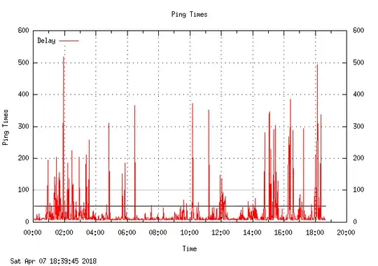

Here are some programs I use to monitor my systems. Any variation of these would be able to be used as the basis for a program which acts on the results via PiGPIO as described below.
fping in Python to monitor delays and to see if systems are alive.

I use a similar method for a ping-delay monitor:

which produces a datafile that looks like:
2018-04-04  00:17:52    50.87.249.67 : 6.56
2018-04-04  00:18:52    50.87.249.67 : -
2018-04-04  00:19:52    50.87.249.67 : 7.41
2018-04-04  00:20:52    50.87.249.67 : 10.99
The line with the - is a line where there was no response in 3 seconds.
I use this output with a gnuplot program to plot it all out.
set title "Ping Times"
set xlabel "Time"
set ylabel "Ping Times"
set yrange [0:*]
set grid
set timestamp
unset mouse
unset log
set key top left
set xdata time
set timefmt '%H:%M:%S'
set xtics format '%H:%M'
set datafile missing "-"
set y2tics
set terminal x11
set style fill solid 1.0
plot 50 lw 1 lc rgb "black" notitle, \
    100 lw 1 lc rgb "gray" notitle, \
    "today.dat" using 2:5 skip 2 with lines lc rgb "red" t "Delay"
pause 11
reread
to get a live plot:
