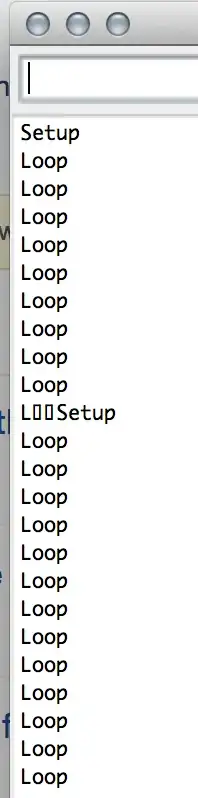

If I upload any sketch that sends serial data, I immediately see the TX/RX LEDs flash once the sketch is uploaded. If I then start the serial monitor, the sketch appears to restart.
A bare minimum sketch that shows this behaviour:
    void setup()
        Serial.begin(9600);
        Serial.println("Setup");
void loop()
  Serial.println("Loop");
  delay(1000);
Tested with several boards and Mac and Windows versions of the IDE.
Example output - it goes back to "Setup" when I open the serial monitor:
Restart
Why is this?

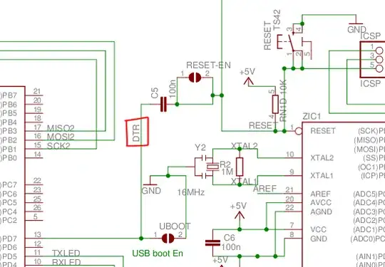

The truth is always in the datasheets, the schematics and the code:
The Arduino UNO actually uses the /DTR line to trigger a reset, as you can see on the following datasheet:
reset schematic
