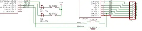

Here is the schematic of the serial port section of the Arduino UNO...
The TX pin on the header is connected directly connected to the TXD/PD1 pin on the ATMEGA chip as highlighted in red. This pin will be actively driven if any of the following happen...
  1. There is a sketch running on the Arduino than enables the serial port (i.e. includes Serial.begin()).
  2. There is a sketch running on the Arduino that enables pin 1 as output (i.e. includes pinMode(1,OUTPUT);).
  3. The Arduino reboots and runs the bootloader, which always briefly enables the serial port on startup.
There are some devices that can be permanently damaged by having their serial output tied to an actively driven signal, especially a +5 volt one like we have here. The BBB is one of them (I know from experience!).
