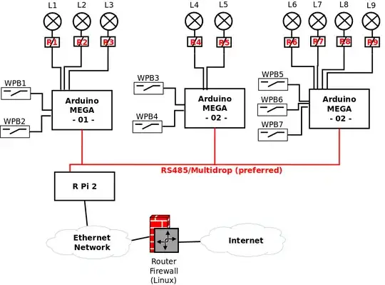

First, your use of Megas seems an overkill, unless you already have them to hand. A Uno, or one of the smaller form-factor boards would seem to be perfectly adequate to monitor a few switches and turn on a couple of lights.
Even the Rpi seems unnecessary. Another Uno could easily monitor your RS485 lines and connect via Ethernet (an Ethernet shield) to the rest of your house or whatever you are doing.
... there is no provision to avoid "collisions" when communicating ...
Well, you build that in. You give each Mega an address (eg. stored in EEPROM) and then you "address" the one you want, and then wait for a response. For example, in the code from my page above:

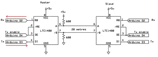

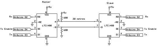

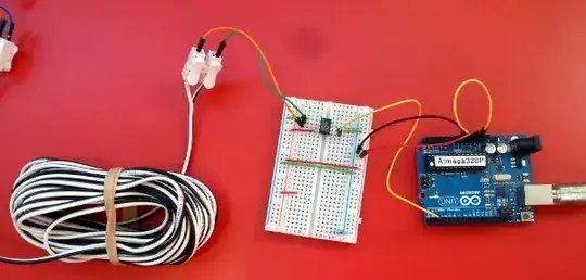

My wiring:
To demonstrate the idea, I set up two Unos, connected via about 8 m of bell-wire (not even twisted pair, and certainly not shielded).
One Uno was running the standard ASCII table sketch (at 9600 baud), its Tx pin went into the LTC1480, and then the A/B pins went to the bell wire.
The other Uno was connected as a USB interface (Reset connected to ground) and it was just echoing whatever arrived on the Tx pin to the USB.
As far as I could see, it worked perfectly.
I will not need any poll at all, as with your approach I can implement a "single-master/multiple-slave" context... but with a "moving" master. Is this right?
My answer above assumed that the slaves were more likely to fail than the master (can't quite think why this would happen, but perhaps based on the fact that there are more slaves than masters, and the master doesn't control things like lights).
I find my Arduinos extremely reliable when doing simple things (like unlocking a door when a RFID card is presented).
You could conceivably build a fall-back position into the slaves. After all, if they get polled every second, and then no poll arrives, they could conceivably attempt to take over as master, perhaps in ascending order of device number, to avoid conflicts. Part of this polling by the "new master" could be to check the "original master" to see if it was ready to resume its duties.
The library I described on my linked page has error checking built into it, the idea being that by checking a CRC on the packet you ensure that you don't come in half-way through a packet and misinterpret the data in it.
You could also build in some randomness of poll times to resolve a deadlock if two slaves attempted to become master at once. If a slave failed it could wait for a random (and increasing) time before trying again to give another slave a chance to do it.
I just wanted to note that the chance of packet collisions is rather low. You only send packets when a switch is pressed, or when a light needs to turn on.
Gerben is right, but I would be worried that a notification about a switch had gone unnoticed. One possible work-around here is rather than the slaves replying with state changes to a query, they reply with the current state. So it might go:
Master: Slave 3, what is your status?
Slave 3: Lights 1 and 4 on, lights 2 and 3 off.

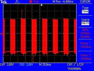

Demo of master-free system
This was an interesting challenge, so I put together a demo of doing this without having any specific master, as described above.
First you need to set up the current device address, and the number of devices, in EEPROM, so run this sketch, changing myAddress for each Arduino:

Amended schematic

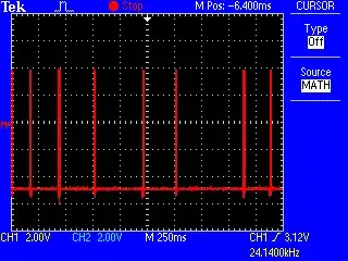

Screen-shots of the code in action
These images show the code working. First, with only one device connected:
You can see from the pulses there that the device is broadcasting its data at randomly-varying intervals, to avoid continuing to clash with another device that powered up at the same moment.
Now we see blocks of data from two devices, with roughly the same size gaps in the middle. I configured it for four devices, but only two are present, so we see two blocks of data, and two gaps.
Now with three devices online, we see three blocks of data, and one gap, as the missing device is bypassed.
If you are checking the figures, these were taken with the baud rate doubled, as a test, to 19200 baud.
Cable run test
For a proper hardware test, I connected the devices up to my in-house UTP cabling. I have cat-5 cable running from various rooms to a central plug-board. Going from one end of the house to another (a reasonable length run) it still works fine. There is 5 m cable between the Arduino and the wall socket, for a start. Plus another 5 m cable at the other end. Then there are about 2 x 15 m runs from the rooms to the switch room, and inside that there is a short bridging cable to connect them together.
This was with the boards still programmed to run at 19200 baud.
