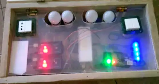

I'm currently assembling a prototype of the lightning infrastructure (based on several MEGAs interconnected via RS485, as described in this other post)
The prototype consists of three MEGAs, a couple of wall-push-button and the two relay modules here below:
Obviously I've:
  • connected one endpoint of each push-buttons to Arduino INPUT-PIN; the other endpoint to ground;
  • connected the relay-module control-pins to Arduino OUTPUT-PIN (and ensuring a properly connected ground).
  • connected lamps to relay-modules power connectors.

P.S.: should you wonder about how the prototype looks like, here is a photo (actually, taken right after the first power-up ;-)
