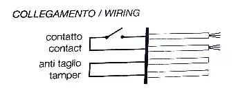

and this is the related circuits:
reed switch circuits
As you can see, it comes with two circuits: one related to the "switch" funcionality; another one as a safety-measure to catch some "cuts" along the wires.
To check its status, currently, I've configured:
  • "contact circuit":
    • one end to an Arduino GROUND_PIN;
    • the other end to Digital PIN 52 (REED1_SW_Pin);
  • "tamper circuit":
    • one end to an Arduino GROUND_PIN (same GND pin as above);
    • the other end to Digital PIN 50 (REED1_AT_Pin);
  • Arduino setup:
    • pinMode(REED1_SW_Pin, INPUT_PULLUP)
    • pinMode(REED1_AT_Pin, INPUT_PULLUP)
  • Arduino code:
    • the main code-block handling REED events is reported below
Even tough everything is working fine, I wonder if there are better approaches, expecially inchecking the status of door and windows without the need to physically watch them terms of POWER-CONSUMPTION. So, here are my questions:
  1. TAMPER-Circuit: due to its nature, it will always be a "closed" circuit, with current flowing inside, from REED1_AT_Pin to GND. Currently I'm checking its state every 1 second (#define REED_AT_CHECKDELAY 1000) but a frequency of once every 5 seconds, or even 10 seconds would be acceptable (for me). So I would like to have the current flowing ONLY during the "checking-timeframe". Something like:
    • every 5 seconds...
    • power-up something, getting the current flowing along the circuit;
    • check if the current flows;
    • if yes => OK
    • if no => set/keep the ALARM state
    • power-down the "something"
Is it feasible? If yes, how? Also: is it worth the effort?
  1. REED-switch circuit: same as above. Polling approach is still acceptable (for me) but frequency need to be relatively high (5 seconds max), in order to keep of sort of "near-real-time feedback" when opening/closing windows. Best would be 2 secs polling-interval. With such a timing, does the polling-approach make sense?
  2. from an "electronic" point of view, what is the "to-be-preferred-scenario" for the Arduino board:
    • having a small, fixed, steady current, flowing out from a PIN, for YEARS on a 24/7/365 basis or...
    • having a continuosly transition from LOW->HIGH->LOW for a Digital PIN, say once every 5 seconds, again, for YEARS?
Every comment, sidenotes, hints, critics, whatever... is REALLY welcomed/appreciated.
Turn off the pull-up until just before checking. Allow a few milliseconds for the pull-up to raise the voltage.
Certainly, if you are trying to save battery power.
Bear in mind the voltage drops over long cable runs (and also possibly induced spikes). You might want a more powerful pull-up (eg. 10k) rather than the inbuilt 50k. You can still organize that by having an output pin turn on the voltage to the pull-up. Or, have the pull-up wired in permanently but instead of running the other side to ground, set the "ground" wire to OUTPUT and write LOW to it - and then set it to INPUT when you want it to be inactive.
See my post about Power saving - you could use a watchdog timer to wake the device at (say) every 4 seconds, to check things.

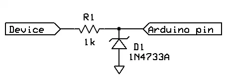

You may want to add in input-circuit protection (eg. a couple of diodes) to dampen down any incoming spikes. Even something simple like this:
Input protection
