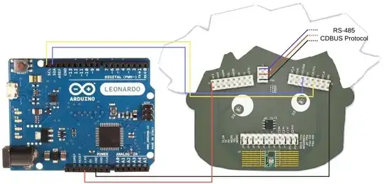

I thinks the easiest way for software is not use any software do this at all, using a hardware controller chip/module instead which dedicated to support multi-master and arbitration for RS485 (the same way as CAN bus).
There is a protocol, named CDBUS, witch has stand-alone controller to do the work for you, which is very simple, I can even transfer video stream through it, details:
https://github.com/dukelec/cdbus_doc (Introduction)
https://github.com/dukelec/cdbus_ip (Protocol details & FPGA IP core)
cv_demo
You can also achieve this protocol by software only, if you don't care the speed or CPU usage.
Update: connect the CDCTL-Bx controller to an Arduino: arduino and cdctl
