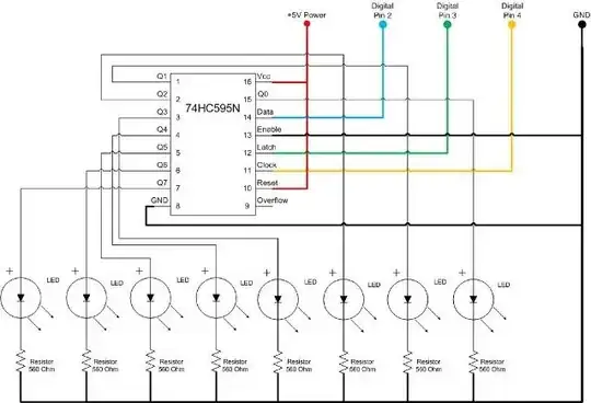

A common way to expand the set of available output pins on the Arduino is to use shift registers like the 74HC595 IC (link to datasheet).
You need 3 pins to control these chips:
  1. Clock
  2. Latch
  3. Data
In a program, you pass on the data one bit at a time to the shift register using the shiftOut() command, like so:
shiftOut(dataPin, clockPin, data);
With that command, you set each of the 8 outputs on the 595 IC with the 8 bits in the data variable.
With one 595, you gain 5 pins (8 on the IC, but you spend 3 to talk to it). To get more outputs, you can daisy-chain a series of 595 together, by connecting its serial-out pin, to the data pin of the next one. You also must connect together the clock and latch pins of all of the 595 ICs.
The resulting circuit (using one 595) would look like this:
Circuit using 595 shift register
The figure above was taken from this codeproject.com webpage:
The latch pin is used to keep the 595 outputs steady while you are shifting out data into it, like so:
digitalWrite(latchPin, LOW);
digitalWrite(latchPin, HIGH);

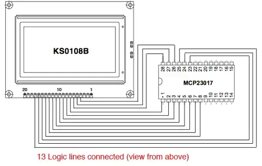

I2C (Wire)
You can use the I2C protocol (Wire library) to connect to other devices such as port-expanders. For example, the MCP23017.

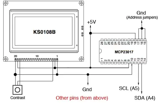

I used one of those chips to connect to an LCD board. The MCP23017 has 16 ports, which can be configured as inputs or outputs. As inputs they can raise interrupts if desired.
Example of connecting 13 of those 16 to the LCD:
MCP23017 connected to LCD screen
Now we connect to the Arduino using only 2 wires (SDA/SCL) plus power and ground:

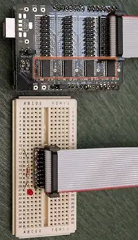

Some third-party manufacturers have made boards with 4 x MCP23017 on them, this gives you 64 inputs/outputs:
Centipede board

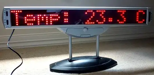

I found inside a commercial LED sign that the 72 LEDs were driven by 74HC595 chips.
Scrolling LED sign
This had 9 chips driving the columns (9 x 8 = 72 LEDs) and one chip driving the rows, in a multiplexed configuration.

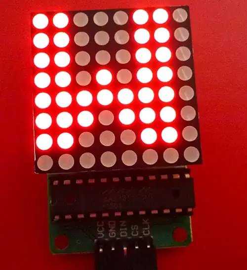

SPI with MAX7219

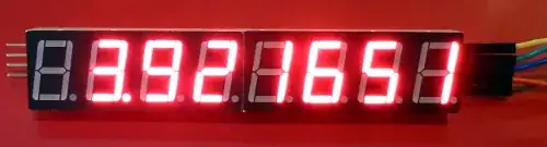

If you just want to drive LEDs you can usually multiplex them. The MAX7219 simplifies that by being designed to drive LED matrixes, for example 7-segment displays:
MAX7219 with 7-segment display

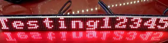

Or 64-LED matrixes:
MAX7219 with 64-LED matrix
In both cases these can be daisy-chained together, for example:
MAX7219 daisy-chain
All those examples only use 3 pins of the Arduino (MOSI/MISO/SCK) plus power and ground.

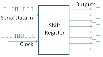

In addition to Ricardo's answer, what Wikipedia states on shift registers:
One of the most common uses of a shift register is to convert between serial and parallel interfaces. [...] SIPO registers are commonly attached to the output of microprocessors when more General Purpose Input/Output pins are required than are available. This allows several binary devices to be controlled using only two or three pins, but slower than parallel I/O.
In the article Ricardo linked you can see the diagram of the shift register.
Shift register diagram

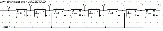

What happens here is that you put the data of the 8 pins in a sequence and for each clock tick the shift register will shift (move the binary data from each latch to the next one) until it "makes a circle" i.e. the first bit arrives to the last pin. Shift registers also have an input where you can turn on/off the shifting so the status can be kept after the data is shifted to the position. For a simple demonstration see the following animation.
Shift register animation
Here the red light is the serial input and the green ones are showing the state of the latches in this simplified SIPO shift register. After the data shifted to place shifting can be turned off and you can read the pins. In this example I shifted out 10101011.
From these examples you can realize that serial transfer will be slower than parallel, because you have to wait for the shift register to shift the bits to their place. You will have to wait the same amount of clock tick as many bits you want to load. This is one of the many reasons why you can't chain them indefinitely, because loading would take forever.

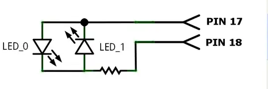

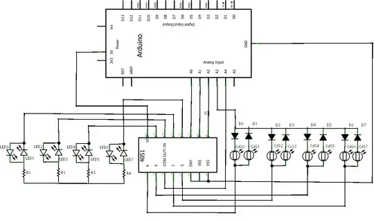

I do not claim this method for my own, but I found this neat trick on the webpage MUX-DEMUX: CD4051 Parlor Tricks
Whatever method you choose to use to drive outputs or read inputs (shift registers, multiplexors or the straightforward direct use of the Arduino pins themselves) you can DOUBLE the number of outputs or inputs by a clever use of parallel circuit pairs (to form a dual input or output bank), employing diodes in opposing senses on each parallel branch, and switching the inputs/outputs to high and low.
To illustrate the method for outputs (LEDs in this case, note that the extra diodes are not required):
LED bank
If you consider the pair of LEDs in this example to be a "bank", and you want to light LED_0, you need to set PIN 17 to HIGH, and PIN 18 to LOW. (The pin numbers are confusing, but they match the later example so bare with me). To light LED_1, you just reverse the PINS. The diode nature of LEDs keeps the current from flowing the opposite direction keeping the other one off.

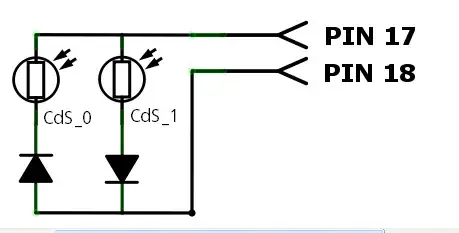

To illustrate the method for inputs (CdSs in this case, note that the extra diodes are required):
CdS bank

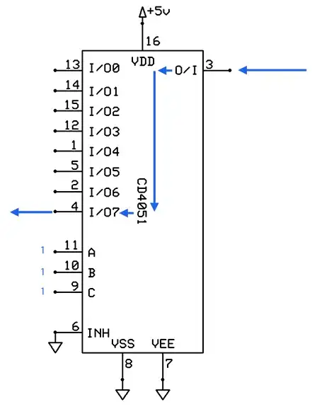

This gets a little more complicated if you want to do an analog read on a CdS light sensor. First, you need to add a diode to each sensor to control the flow. Second, since you are reading values, you need to pull the inputs high or low to keep them from floating. Being a lazy person, I'm going to pull them high using the internal pull-up resistors. To read CdS_0, you set PIN 17 mode to OUTPUT and set it to LOW. This makes it the ground. Then you set PIN 18 mode to INPUT and set it to HIGH to engage the pull-up resistor. Now you are set to do a read on PIN 18 (a.k.a. analog pin 4). To access the other sensor, just switch the modes and outputs.
So, if you have a CD4051 8 port multiplexor, using 5 pins on the Arduino (instead of the usual 3), you can obtain 16 inputs or outputs, or a mix of the two.
16 outputs/inputs using a CD4051
Likewise, if you have a 4067 16 port multiplexor you can obtain 32 inputs or outputs, or a mix of the two.
