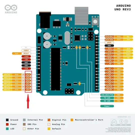

It sounds like you are using some GPIOs ;) If you need more digital pins, you can use the analog pins as digital pins (if you didn't already).
Arduino Uno analog pins as digital pins
If you already occupied these pins, then I would think about getting an I/O expander. It's a chip/IC that can be mostly controlled via I²C, offering you a way to scale your project's GPIO capabilities.
