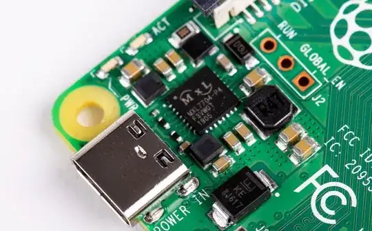

  1. PMIC
The Foundations blog shows this picture of the power management section on the PCB. The PMIC is a MXL7704 - the same IC is used on the Pi 3B+.
