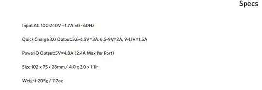

So I'm thinking of getting a Raspberry Pi 4 and I know they have raised the power requirements to 5v 3amps, rather than buying the offical power supply would using the two blue fast charge ports on my Anker PowerPort Speed 5 be okay with the specs below?
Here is a link to the item in question.
https://www.anker.com/products/variant/powerport-speed-5-ports/A2054111
Quick Charge 3.0 Output:3.6-6.5V=3A, 6.5-9V=2A, 9-12V=1.5A
PowerIQ Output:5V=4.8A (2.4A Max Per Port)

It should work. Both USB 3 power delivery and Qualcomm Quick Charge ports default to 5V output, other voltages must be actively negotiated. RPi 4 doesn't support such negotiation protocols, so the voltage will stay at 5V.
