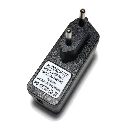

Could someone suggest tools/methodology to investiage possibly failing power supply ? I am using a cheap DSM-0525 from ebay: DSM-0525
Which is supposed to power the RPI3b and the HD-PNTU3 :
The Power Supply is supposed to produce 2500mA output which seems to me should be plenty for both:

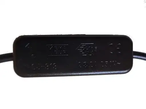

For later reference the original USB cable is 150 cm long and contains a OJ-313 switch:
The new short cable does not contains any switch anymore.
