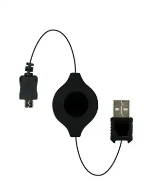

Cables do make a difference once you start to draw hundreds of mA or several A.
You can often tell how much current a cable can carry simply by its looks. Anything thick and stiff is good, thin and overly flexible may cause trouble. Check out these pictures to see what I'm talking about:
enter image description here VS enter image description here
Cable length also has a similar effect: Shorter cables are much better for high current draw compared to longer ones.
