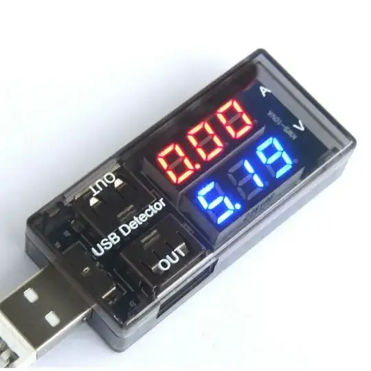

You can measure the current draw of the one and two cameras with an ammeter (example from eBay):
And determine if you have enough current for:

The USB meter shown above should also be used to read the voltage and ensure it stays always greater or equal to 5V. With both cams and all app / cam / whatever processing.
