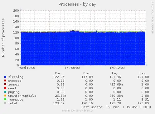

Processes - by day

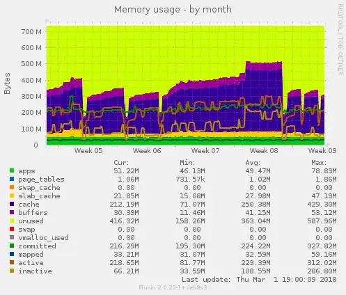

Memory usage - by month
