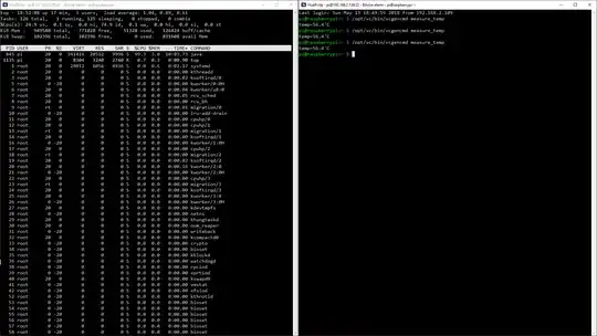

So I‘m currently working on a program to turn on or off my Philips Hue lights when I enter my room. The detection if somebody is coming or which direction he is going is provided by one HCSr505 and two HCSr04 sensors. The program is a java program with the official Hue API. So now my problem is that the Raspberry Pi 3, which the whole system is running on, is getting quite hot (around 60 °C) over time( the system is running 24/7, but the loops to detect the distance from the HCSr04 is only running when the HCSr505 is detecting any movement, at certain day times all loops are paused, because I don’t need to turn on light when the sun is shining). I know that 60° is okay for the raspberry pi but nevertheless I’m a little bit worried because the system is placed in a wardrobe where there’s no way the hot air can escape. I‘ve also mounted heatsinks onto the pi. Is there any way I can decrease the temperature while running my java Programm? Here's the cpu usage while running the program: enter image description here

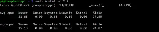

And here's cpu usage I got from the iostat command: enter image description here

Janik
Your application should not be hogging an entire core; notice the amalgamated figures (the average of four cores) are 20-25% and the listing in top is 99% (top can show individual threads, so this is the usage of one core).
While if nothing much else is going on this may work out okay (the task will hopefully rotate from core to core), it is unnecessary, particularly since you are probably begging for it not to work out okay at some point. This is not a very robust methodology.
The problem is here:
Thread.sleep(20)
If this is about video motion detection, this could be much longer. You could use something in the range of at least 100 - 200 ms and everything will work the same anyway.

56,4°C is nothing I would worry about, this is not a threat to your RPi. The firmware will show you a temperature warning starting at 80°C and "if the temperature of the SoC is over 85C, the [...] ARM core(s) and the GPU will be throttled back in an attempt to reduce the core temperature" (source: Firmware warning icons - Raspberry Pi Documentation). It's pretty self-regulatory.

If your RPi has heavy load, I would recommend a fan, but based on your screenshots your CPU is 77% idle and the "load avg" is very low (zero point something). Maybe better code can reduce load/heat, but your system status looks fine to me. Your SoC has only around 60°C, so I would not recommend to invest time on a sideshow like code review and software optimisation. (Side note: to monitor your RPi you can use Munin.)
