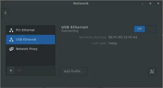

Answering to myself: I found the answer now (actually I don't really know, why it works, but it works).
  • Open Network Settings. If the Zero is connected and active, you'll find an entry for "USB Ethernet" Ubuntu network settings
  • Click the Settings-Button on the lower right.
  • Go to the "IPv4" Tab and change "addresses" to "Link Local only"
  • Go to the "IPv6" Tab and turn it "Off".
After a few seconds, the network will say "connected", and then you can ssh to the zero with "ssh pi@raspberrypi.local"
Still, the Pi doesn't have internet connection. A network bridge would be necessary for that.
