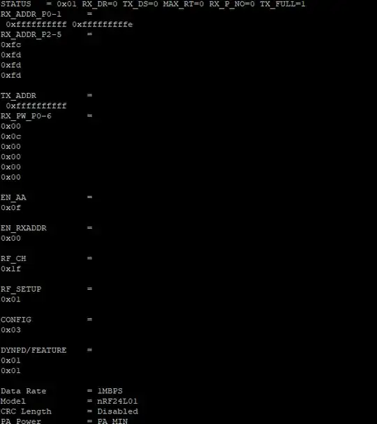

i also working with nrf24l01 and raspberrypi it works before after update it is not working crc length disable gettingenter image description here
