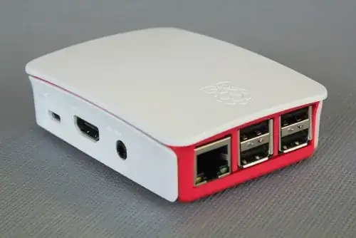

I'm working on making a case for the project SamplerBox.
I would like 2 or 4 USB ports of the Raspberry Pi to be reachable from outside the case, like the photo below.
But then, how to access USB from inside the case? I need to access USB inside the case to connect a 2nd SD card reader.

Do you have an idea / solution for making a case such that:
  • the 2 or 4 USB ports are available outside the case for the user (for example to connect a USB MIDI keyboard, etc.)
  • inside the case, one USB port should be connected to a PCB SD card reader under the hood
