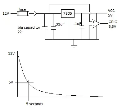

I've been thinking that it should be possible to create a simple circuit with a capacitor and probably a diode to detect when the power supply was disconnected (and raise an interrupt on one of the GPIO pins) but the capacitor would provide current long enough for the system to shut down properly.
first draft
Does this look correct and sufficient?
...Actually, I think it would probably be more like this:
second draft
What kind of capacitor would I need to store enough charge to keep the Pi going long enough for XBMC to shut down properly?

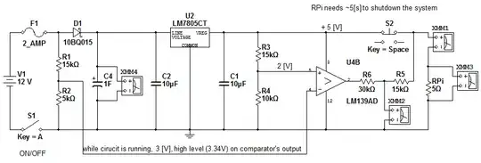

Comparator's output goes to GPIO pin (in this circuit there is placed multimeter instead) so that Raspberry could check if car's ignition is still on. Everything else is explained by the previous speaker. "S2" is a reset buttun - just in case. In the picture you can see XMH4, XMM1,.. Don't care about it. I've used it only to check interesting parameters while testing circuit in Multisim. My only question is reaction to rising temperature. Perhaps, there will be need to change the values of resistors in voltage dividers.
Edit: I've realised that in spite of the fact that the cirucit is surely correct in the theory, it is useless. Cost of such a big capacitor (1F, 12V) is unacceptabe high. Another solution might be connecting voltage regulatior stright to acculumator and using voltage comparator between car's ignition and the battery.
