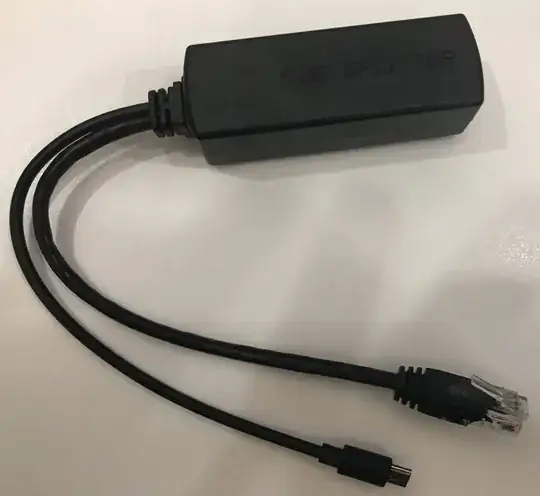

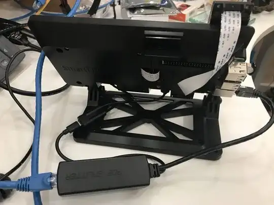

Connect your Pi's to a PoE switch and simply disable and then re-enable the port of the Pi you want to bring back up. I just VPN into my network and access the PoE switch on it's local IP and start up a pi from a shutdown-state.
(2) Methods for PoE-enabling a Pi:
PoE Hat: Just whack this on top of your Pi and light it up with an Ethernet cable connected to a PoE switch. PoE Hats are £20 from all Pi Resellers.
PoE Splitter: This doesn't require modifying the Pi. Plug this dongle on the end of the Ethernet cable connected to the PoE switch and the Ethernet cable from the dongle into the Pi's Ethernet Port and the MicroUSB cable from the dongle into the Pi's standard power MicroUSB port. Works with any Pi model and leaves it free to use a different hat (than the PoE hat). £9.90 from Amazon at the time of this writing.
ZyXEL GS1900-8HP-GB0102F PoE Switch: The one I use and recommend to re-animate shutdown Pi's is the ZyXEL GS1900-8HP-GB0102F. Great PoE switch with lots of bells and whistles and supports PoE (802.3af) and PoE+ (802.3at). £97 inc VAT
PoE Splitter
PoE Splitter being used to power both a Pi 3B+ AND a 7" Touchscreen Display
