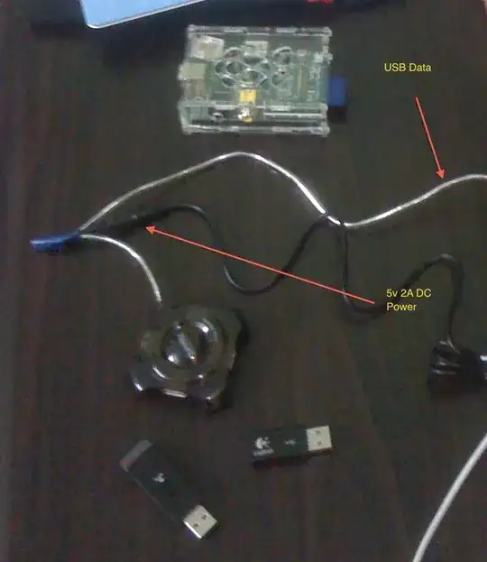

I have put together a DIY External Powered USB Hub by following the instructions. (Instructables, htc-linux)
  • USB hub with 4 ports
  • 5v 2A AC/DC power supply (It varies when tested with multimeter, 5.3 ~ 5.5)
DIY hub
Unfortunately it doesn't seem to work. Here is the lsusb -v I try plugging Logitech K260 and Netgear N150 - WNA1100 wireless adaptor, nothing was detected when connecting via Hub. I couldn't figure the issue, I tested for the connectivity of of the 4 points (+5 D+ D- GND), seems to be working.
I would like to use my Netgear N150 instead of LAN cable. Though it is detected if connected directly, it doesn't connect. I assume it is due to power requirement, it is the reason why I built this USB hub in first place.
Here is the output from lsusb -v

[  340.933405] hub 1-1:1.0: connect-debounce failed, port 2 disabled
[  343.493475] hub 1-1:1.0: connect-debounce failed, port 2 disabled
[  346.053492] hub 1-1:1.0: connect-debounce failed, port 2 disabled
[  348.453463] hub 1-1:1.0: connect-debounce failed, port 2 disabled
[  350.923518] hub 1-1:1.0: connect-debounce failed, port 2 disabled
[  353.483453] hub 1-1:1.0: connect-debounce failed, port 2 disabled
[  356.043399] hub 1-1:1.0: connect-debounce failed, port 2 disabled
[  358.603458] hub 1-1:1.0: connect-debounce failed, port 2 disabled
[  361.163388] hub 1-1:1.0: connect-debounce failed, port 2 disabled
[  363.723483] hub 1-1:1.0: connect-debounce failed, port 2 disabled
[  366.283406] hub 1-1:1.0: connect-debounce failed, port 2 disabled
[  368.843473] hub 1-1:1.0: connect-debounce failed, port 2 disabled
[  371.403416] hub 1-1:1.0: connect-debounce failed, port 2 disabled
[  373.963476] hub 1-1:1.0: connect-debounce failed, port 2 disabled
[  376.523418] hub 1-1:1.0: connect-debounce failed, port 2 disabled
[  379.083486] hub 1-1:1.0: connect-debounce failed, port 2 disabled
[  381.643547] hub 1-1:1.0: connect-debounce failed, port 2 disabled
[  384.203489] hub 1-1:1.0: connect-debounce failed, port 2 disabled
[  386.603410] hub 1-1:1.0: connect-debounce failed, port 2 disabled
[  389.073464] hub 1-1:1.0: connect-debounce failed, port 2 disabled
[ 1562.719882] hub 1-1:1.0: connect-debounce failed, port 2 disabled
[ 1565.280058] hub 1-1:1.0: connect-debounce failed, port 2 disabled
[ 1567.840249] hub 1-1:1.0: connect-debounce failed, port 2 disabled
[ 1570.400439] hub 1-1:1.0: connect-debounce failed, port 2 disabled
palaniraja

It may be over voltage. When they say the USB spec is 5 V it's usually much closer than 5.3. The fact that the power supply ranges so much isn't a good sign. It could be causing continued resets on the Wi-fi or activating its over-voltage protection. Try to see if you can clean up the power-supply's output some (or try a phone charger temporarily?). A 5 V Zener diode should protect more from the over-voltage at least.
