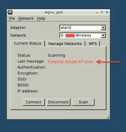

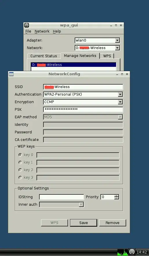

After my failed attempt with DYI powered USB hub. I managed to power my Netgear N150 directly with RPi native port by supplying 2A 5+V DC to RPi. However, I was not able to connect/configure wifi successfully.

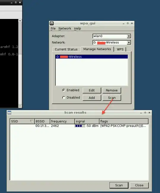

Though power seems to be not an issue anymore, I can scan for network and configure, but i was not able to connect to my network. When I tap on connect, i can see 'Failed to initiate AP Scan' message in the progress.
Find output of lsusb, iwlist scan and ifconfig below.

pi@raspberrypi /boot $ iwlist scan
lo        Interface doesn't support scanning.
wlan0     Scan completed :
         Cell 01 - Address: 00:1F:33:25:C2:94
                   Channel:11
                   Frequency:2.462 GHz (Channel 11)
                   Quality=70/70  Signal level=-24 dBm
                   Encryption key:on
                   ESSID:"\x00\x00\x00\x00\x00\x00\x00\x00\x00\x00\x00\x00\x00\x00"
                   Bit Rates:1 Mb/s; 2 Mb/s; 5.5 Mb/s; 11 Mb/s; 6 Mb/s
                             12 Mb/s; 24 Mb/s; 36 Mb/s
                   Bit Rates:9 Mb/s; 18 Mb/s; 48 Mb/s; 54 Mb/s
                   Mode:Master
                   Extra:tsf=00000000c3bd6181
                   Extra: Last beacon: 3700ms ago
                   IE: Unknown: 000E0000000000000000000000000000
                   IE: Unknown: 010882848B960C183048
                   IE: Unknown: 03010B
                   IE: Unknown: 050400010000
                   IE: Unknown: 2A0100
                   IE: Unknown: 32041224606C
                   IE: IEEE 802.11i/WPA2 Version 1
                       Group Cipher : CCMP
                       Pairwise Ciphers (1) : CCMP
                       Authentication Suites (1) : PSK
                      Preauthentication Supported
Network config
Scanning

I couldn't make it to work even with external powered USB hub. Same "Failed to initiate AP Scan" but "Scan" functionality works. Issue is only with connecting to a access point.

I got my Netgear N150 working by adding ap_scan=0 to /etc/wpa_supplicant/wpa_supplicant.conf

This post from Mirko Sertic solved my problem. Here are the steps even for Linux newbies :
  • Open a terminal (black icon)
  • Type sudo nano /etc/rc.local
  • Type following 4 lines just before exit 0
modprobe 8192cu
echo "0846 9043" > /sys/bus/usb/drivers/rtl8192cu/new_id
ifdown wlan0
ifup wlan0
  • Do a Ctrl+X to save, answer Y for Yes, and hit enter to validate filename
  • Edit another file: sudo nano /etc/modprobe.d/netgear_n150.conf
and type this line:
install 8192cu /sbin/modprobe --ignore-install 8192cu; echo "0846 9043" > /sys/bus/usb/drivers/rtl8192cu/new_id
  • Ctrl+X, Yes, Enter
  • Type sudo shutdown -r now to restart your raspberry
  • Launch Wifi connection Gui by typing 'wpa_gui' in terminal (I don't know where the icon is). Selected adapter should be "wlan0", and nothing is displayed in "Network"
  • Click on "scan" in the bottom of the window
  • You obtain a list of Wifi access points.
  • Double click on the name of yours, and enter security settings
  • Click on "Add", close list window
  • It should display "Status : Completed (station)". Click on "connect"
  • Do a "File / Save configuration" (I'm not sure of that).
  • You could now "connect" to your Wifi spot
