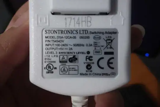

I'm currently using a 5V 2A power supply; not sure if it is appropriate because some answers say that the max safe current is 1.2 amps. I'm a little confused about this. Is it safe to use my current power supply?

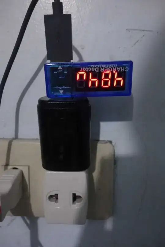

Yes it is safe. The raspberry pi will only draw the current it requires. I use a 1.2A power supply and my raspberry pi draws only 0.53A while running a stereo vision algorithm in the background. This is what i used to test it:

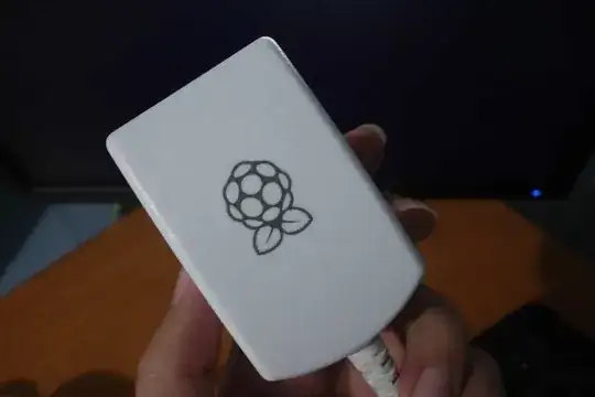

A higher ampere rating on a charger would give you more flexibility such as when adding more usb type peripherals such as a Mouse, Keyboard and Hardrive. The official raspberry pi charger itself is rated at 2A. I am using both chargers, one each for Pi (I have 2 Pi's).
