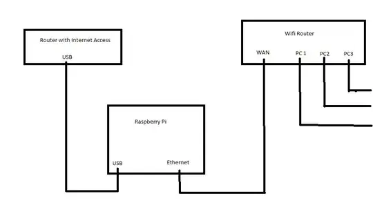

Can I use RPi as Internet Gateway/Bridge, with the possibility to control the network bandwidth depending upon local IP?
I would like to setup as follows, and I tried the tutorial at http://raspberrypihq.com/how-to-turn-a-raspberry-pi-into-a-wifi-router/ making some modifications, but still no luck.
The RPi recognized the Ethernet port as "eth0" and the USB port connected to Router(with Internet) as eth1, so I setup only the NAT Bridge and DHCP server and also replaced every occurrence in the tutorial as follows,
wlan0  =>  eth0
eth0  =>  eth1

RPi is trying to access the internet from its Ethernet port(eth0), but the internet is actually on USB port(eth1).

Here's how it would visually look like:
               WAN                      |               LOCAL / LAN
                                        |                    +----------> Device 1
                          +-----------------+ eth0           |
                          |Raspberry Pi |   <----+           |  +-------> Device 2
                          |1. NAT       |   |    +----+ WiFi Router +---> Device 3
+----------------+        |2. Masquerade|   |         +------+------+
|External Network<--------+3. Forward   |   |                |  +-------> Device 4
+----------------+  eth1  +-----------------+                |
                                        |                    +----------> Device 5
