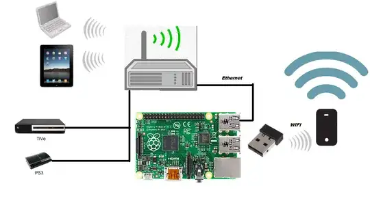

I've got several devices connected to a Sky router (Sky Hub SR101) via Wi-Fi and Ethernet.
I have a USB Wi-Fi dongle connected to my Raspberry Pi, and I use it to connect to a 4G smartphone. That works fine - I have access to the internet from the Raspberry Pi.
What I wanted to know is if it is possible to keep all the devices connected to the Sky router and share the 4G coming from the smartphone... through the Raspberry Pi, that acts like the gateway to the internet?
If I get another device, can I easily connect it to the 4G network just by connecting it to the Sky router (instead of the smartphone directly)?
[Note that the Sky router has no connection with the internet.]
Diagram of connected devices

I think you want to follow: http://www.skyuser.co.uk/forum/asking-help/41883-how-connect-two-routers-together.html
The only difference is that your Raspberry Pi and 4G combo is the gateway router (i.e. the one with the WAN connection).
You'll also want to set up your Pi to forward packets from the wired interface to the wireless interface. This tutorial does exactly that, but in reverse, so wherever it refers to eth0, you should substitute wlan0 and vice versa: http://qcktech.blogspot.co.uk/2012/08/raspberry-pi-as-router . You might also look at RPi as Internet Gateway/Bridge

I found exactly what you need: https://www.diyhobi.com/share-raspberry-pi-wifi-internet-ethernet/
Raspberry Pi shares the internet it gets from a wifi and forward it to ethernet connected to a router.
Raspi becomes a DHCP server instead of the router so internet is distributed from Raspberry Pi Wifi to any devices connected to the router via cable or via wifi.

This can work if the RasPi and the phone are in a second Wi-Fi network (so other devices cannot circumvent the RasPi). The RasPi can be configured as a gateway, there are tons of tutorials on how to do this.
However, you either have to connect the RasPi to the WAN port of the router, or you need to manually configure the IP settings of all devices, because the router would set itself as the gateway when handing out IP configurations over DHCP.
