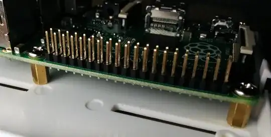

Just to add to the already correct answers, there's enough leeway to enlarge the PCB holes to M3 size so that you can use standard PC floppy drive screws, of which any PC enthusiast is likely to have a surplus. These often fit into the brass motherboard stand-offs that come with PC cases (and are readily available online) so it makes for a cheap and easy way to securely mount the Pi.
Just remember to use a drill to enlarge the holes, as forcing an M3 screw through the original sized hole makes cracking sounds and so you risk snapping the PCB that way.
You also need to avoid the older screw design that has a washer molded into the screw head, as this makes the screw head diameter too large and it scrapes against surrounding components like the micro USB connector, while being screwed in. Newer screw designs (~mid 2000s) seem less likely to have this shape so aren't a problem.
Here's a photo of a Pi mounted with floppy drive screws into motherboard stand-offs, which are themselves screwed into a plastic case (after drilling 2.5mm holes into the plastic to ensure a tight fit for the standoffs).
Pi with M3 floppy drive screws and motherboard stand-offs
