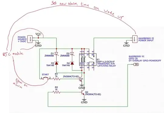

I'm looking into powering my raspberry pi via a powerbank. I already have a button and a relay to turn it on manually and when the pi shuts down flip the relay back to off position. Now I would like to have the option to power up the pi at specific times. After some research, an RTC seems promising. The question now is if anyone knows some nice off the shelf, low power, RTC circuit that is able to send out a 5V signal at e.g. 10am to flip the relay into the on position. I would prefer to power it directly through the powerbank instead of a coin battery to prevent having to charge the powerbank and switch out batteries.
for more info on the circuit I'm using to manually power on the pi see: Cut power supply to pi after shutdown and power on after button press
EDIT: The RTC would be an addition to powering it up manually. So both options would be possible. The idea is to build an ePaper photo frame that can change its picture when the button is pressed manually and also change its picture at certain set times. The times and photos will be collected from the accompanying website I built.
I also added a sketch of the adapted circuit that I am currently using for manual turning the pi on and shutting it down once it finished its task. I am a bit of a beginner in electronics so it is still very very basic (sorry for the handwriting).
sketch of circuit alteration

Proposed Solution:
The proposed solution requires hardware and software - including configuration changes to the system. Everything in this proposed solution has been verified on an RPi 3B+ running the Lite version of RPi OS buster.
Hardware
The following circuit seems to meet the objectives given in the OP. It adds three (3) components that weren't needed in the original schematic: the Real-Time Clock (RTC) at U1, a monostable multivibrator at U2- a.k.a. "one-shot" and a 3.3V regulator to power U1 & U2.
  1. For the RTC, I used Adafruit's DS3231 Precision RTC Breakout. The DS3231 is accurate, stable over temperature and has a feature set that includes an alarm function. N.B. "Counterfeit" DS3231 chips are widely distributed in the el-cheapo retail channels for much lower prices than the Adafruit unit.
  2. The one-shot at U2 provides two functions needed to integrate the RTC: It converts the RTC's alarm interrupt (#INT) from a state change to a fixed-duration pulse, and it inverts the signal polarity to drive the NPN transistor at Q1. The SN74AHC123 (available from TI) was chosen, but other one-shots may work equally well. Note that this is a CMOS part, and unused logic inputs must not be allowed to "float" - see the schematic for details.
  3. A 3.3V regulator is added to power the circuitry which must function when power is disconnected from the RPi. The RTC and one-shot draw very little power, and this simple Zener diode regulator is adequate.
RPi Power Management Schematic:
Zero-Power Control for Raspberry Pi

Some Background on 'Zero Power' vs 'Low Power':
As of today, there is no RPi capable of reaching a Zero Power state without external hardware. As long as a 5V power source is connected to the RPi, the RPi will consume power. The RPi's rate of power consumption is reduced during halt, but all models will continue to consume power as long as a power source is connected. It may be fairly stated that all of the energy consumed by a RPi after receiving a halt command is wasted energy - unless your objective is to build a Raspberry Pi handwarmer. Obviously, this lack of power management disqualifies the RPi for a large class of otherwise potential applications; e.g. off-grid, battery-powered.
The RPi 4B is the first RPi model to provide what might be called a Low Power mode. However, as of Feb, 2022, a RPi 4B in LPM still burns 150-200 milliwatts after a halt, and also requires external hardware for re-start. While this is a significant improvement from when the RPi 4B was introduced, this level of power consumption is still too high for many off-grid and battery-powered applications - which is a shame.
Summary of Operation:
Referring to the Power Management Schematic:
Two signals and the K1 relay form the core of this design. INT# and GPIO-POWEROFF act through the support circuitry and the K1 relay to either apply or remove power from the RPi. Relay K1 differs from traditional relays in that it is a bi-stable, or latching relay; one of its two coils sets the relay, the other coil resets it. This bi-stable nature is what enables the Zero Power state: Once K1's contacts are set, they require no power to maintain this state. The contact positions will not change unless the reset coil is energized.
