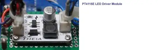

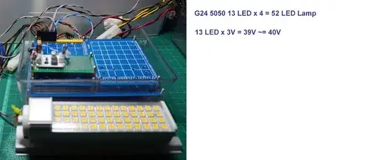

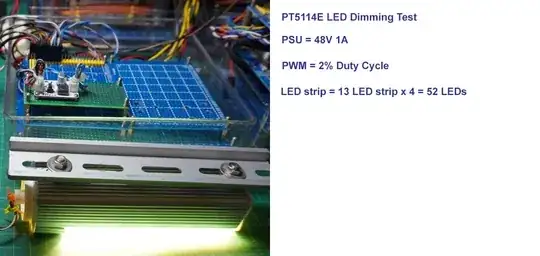

Preliminary test OK - Vcc = 48V, Duty Cycle = 2% Dimming, PT4115E 50V 1A LED Driver Module, 13 LED x 4 = 52 LED 5050 LED Lamp (See Appendix F)
pt4225e test 3

(2) Selection of LED driver module and IC PT4115E
I googled and found that PT4115E based constant current LED driver module and IC best suited the OP's general requirements, except one thing the Vcc max is only 30V.
Errata and apology 2021mar19 - I made a crelesss mistake and mixed up different versions of PT4115, PT4115C, and PT4115E. For PT4115E, the max Vcc is 50V.
PT4115E LED ddriver module
The modules's user manual is a bit too brief. So we need to study the datasheet to get a thorough understanding of the driver IC, before we can DIY our own module using the chip. Another important reason is that the modules seem to use jumpers to change the module characteristics. It would be nice if we can use Rpi Thonny Python to software adjust all the parameters, such as dimming, fading in out (using not just PWM, but also a DC voltage level, which hopefully reduces flickering), and maximum current control etc.

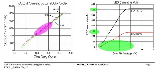

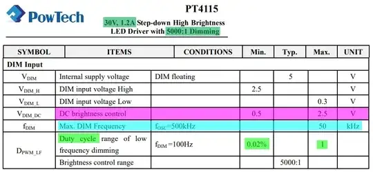

(3) Selection of Dimming Mode
I would prefer DC level dimming over PWM for less brightness flickering.
pt4115 dim
dim pwm dc

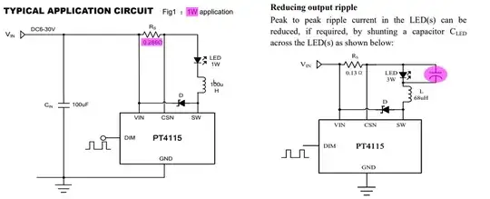

(4) Reducing Peak to Peak Ripple
reducing ripple

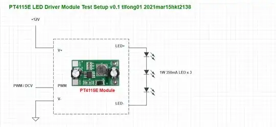

(5) Testing Plan and Hardware Setup
(5.1) Now I am drafting a plan to test the PT4115E LED driver card. The OP's requirement is a dimming a couple of white 350mA LED stripes with 40V, 14W power. I have no experience in using PWM to dim LEDs. So I am thinking of making things as simple as possible. The test plan is summarized below.
  1. Assemble a short LED stripe with only three 350mA RED LEDs.
  2. Use 12VDC as power source.
  3. Use an adjustable DC voltage level, eg a pot or a PSU to dim the 3-LED strip.
led module test setup

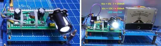

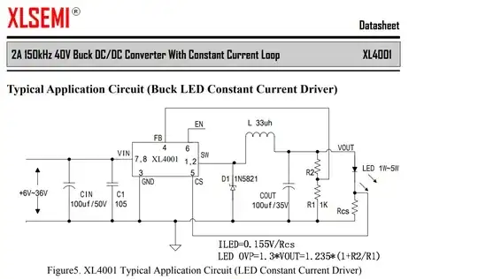

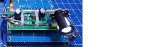

(5.2) Now I have wired the XL4001 LED Driver Module for preliminary functional testing without using PWM dimming dignal.
The testing plan is summarized below:
(a) LED under test = LED x 1 (White, 1W 350mA)
(b) Power supply to XL4001 constant current LED driver module = 5V, 12V
(c) Current to measure = expect 350mA at Vcc = 5V or 12V
(d) PWM = DC 0V (duty cycle 100%) , DC 5V (duty cycle 0%)
test02
(5.3) Test Results (DC Level 0V/5V to turn off/on LED)
(a) Current at Vcc = 5V = 250mA
(b) Current at Vcc = 12V = 150mA (Note - LED has heated up and becomes very hot)
test03

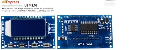

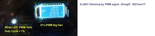

(5.4) Test Results (Using XY-LPWM Square Wave Signal to dim LED Module)
  1. PWM dimming is smooth and flickering free.
  2. Need to use my sun glasses for camera lens filter.
pwm dimming

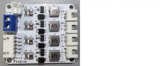

(6) Evaluating a 4 Channel, 50V, 1A x 4, Constant Current, PWM Dimming, LED Module for RGBYW LEDs
Testing a 350mA white LED using a single channel XL6001 module at 5/12V is so far so good. Next step is evaluating the following 4-channel 50V, 1A x 4 module.
AliEXpress THEIA PT4115E LED Driver Board, Constant Current, PWM, Continuous Dimming, Default 4 Channel Output, 4 * 1A - US$15
theia 4ch led module

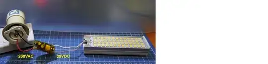

(7.1) The OP specifies 39.6V for his LED stripe. I guess the length or number of LEDs of his strip might be 39.6V / 3V ~= 13
So I tore down a cheapy 200VAC LED to do the testing. I found the power electronics circuit has stepped down 200VAC to 39VDC, as show below.
200vac 39vdc led lamp

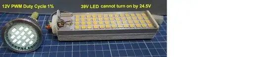

(7.2) Bad luck - the 39V LED lamp can not be turned on by 24.5VDC. I tried another 220VAC LED lamp and found that the lamp steps down 220VAC to 78V DC. I PSU only goes up to 25V, the lamp does not turn on below 25V. So it is another test failure.

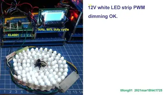

Anyway, I tried another 12V LED Lamp. Good luck this time 12VDC with PWM works OK. The photo below shows the 1% duty cycle brightness.
39v lamp no work by 24.5V
I tested another 12VDC white LED strips and found everything, including PWM dimming OK.
white led pwm

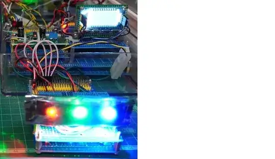

(8) Using Manual and Rpi software PWM to dim RGB LEDs
How can Rpi move a Servo motor using a GPIO pin in PWM mode? - RpiSE, 2019may11, Viewed 2k times
Now I am testing RGB LEDs, with different frequencies and duty cycles. I found 1kHz and 10kHz make no difference. I also found that
(a) the cheapy XY sig gen has a too low resolution of duty cycle of only (The photo below shows frequency = 10kHz and duty cycle = 97%), and
(b) the brightness of the LED could nto be easily adjusted at the 1% end (actually 99% setting).
So I am thinking of using Rpi's GPIO pin in output PWM mode to adjust the LED's brightness.
rgb led test

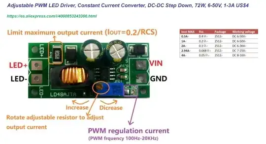

(1) AliExpress Adjustable PWM LED Driver, Constant Current Converter (4A, 30V, US$4)
(2) AliExpress Adjustable PWM LED Driver, Constant Current Converter, DC-DC Step Down, DC 9V 12V 18V 24V 20W - US$1.5

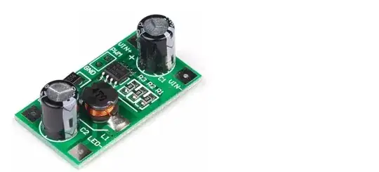

(4) 3W/2W/1W LED driver 700mA PWM 5-35V DC-DC Constant Current Driver - TaoBao ¥4.80

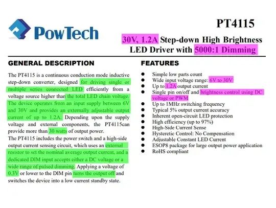

(5) PT4115E 30V, 1.2A Step-down High Brightness LED Driver with 5000:1 Dimming - PowTech Shanghai
(6) AliEXpress 1W LED Driver 350mA PWM Dimming, Input 5-35V DC-DC Constant Current Step Module - US$20/10pcs

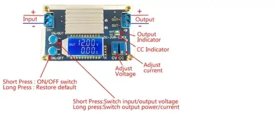

(7) AliEXpress ZK-JVA-12KX 5.3V-32V in, 1.2V-32V out, 12A, 160W, 50mV, 10mA display resolution, 50mV, 30mA accuracy Step Down Constant Voltage/Constant Current Module - US$13

Appendix A - PT4115E Datasheet Summary
pt4115 summary
/ to continue, ...
Appendix B - 1W 350mA LED Spec Summary
led driver
  1. Power: LED-1W 350mA ± 20mA
  2. Input range: 5-35V
  3. Supports high PWM dimming off the low output output.
  4. LED buck mode to ensure that the total pressure is less than the input supply voltage 2-3V to work
  5. Ultra-small size design (length 3.6cm * width 2cm), low noise, safety features.
  6. High efficiency, low consumption and stable chip to achieve energy saving and environmental protection projects.
  7. Constant output current, low ripple.
  8. Overload, short circuit, over current protection.

Appendix D - ZK-JVA-12KX 5.3V-32V in, 1.2V-32V out, 12A, 160W, Constant Voltage / Constant Current PSU
zk_jva_12xx psu
Appendix D - XL Semi XL4001E Constant Current LED Driver
xl4001 led driver
Appendix E - XY-LPWM Sig Gen Notes
(14) How can Rpi4B python UART talk to XY PWM Signal Generators?
xy-lpwm sig gen

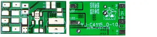

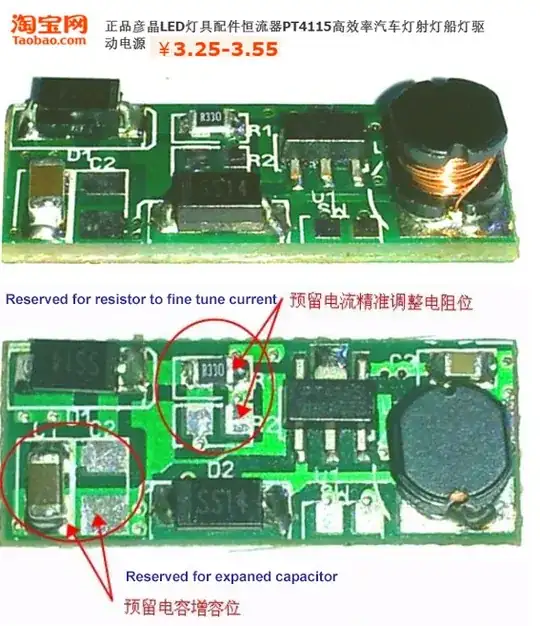

Appenidx F - PT4115 Constant Current LED Driver Module DIY References
PT4115 Constant Current LED Module
PT4115/PT4205/CL6807 LED Module PCB
pt4115 led module
pt4115 led module pcb
Appendix F - PT4115E 6V ~ 50V, 1A LED Ddriver Module Preliminary Test v0.1
pt4115e test 1
pt4115e test 2
pt4225e test 3
