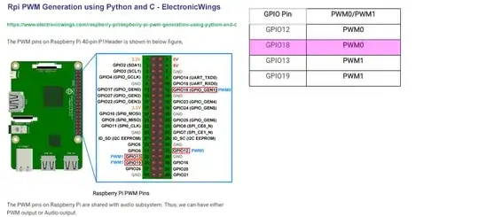

Your program is not very clearly commented, You might like to compare and contrast a similar python PWM segment, in my debugged, complete, copy-paste-run program.
# *** GPIO PWM Mode Setup and PWM Output ***
def setGpioPinPwmMode(gpioPinNum, frequency): pwmPinObject = GPIO.PWM(gpioPinNum, frequency) return pwmPinObject
def pwmPinChangeFrequency(pwmPinObject, frequency): pwmPinObject.ChangeFrequency(frequency) return
def pwmPinChangeDutyCycle(pwmPinObject, dutyCycle): pwmPinObject.ChangeDutyCycle(dutyCycle) return
def pwmPinStart(pwmPinObject): initDutyCycle = 50 pwmPinObject.start(initDutyCycle) return
def pwmPinStop(pwmPinObject): pwmPinObject.stop() return
Notes
  1. My program is written for controlling a toy servo. But you don't need a servo to test. The main point is to understand how to set, start, and stop the PWM pin, which is connected to a servo or a LED. If you use a LED instead of a servo, you should see the LED goes very dim if duty cycle is very small, and full bright if big duty cycle.
  2. Rpi python is running a toy servo at 50Hz PWM. It might go crazy if you ask it to run so ridiculously low a frequency of 0.5Hz. Rpi might complain that 0.5 is not a frequency value!
  3. If you set frequency higher than 25Hz, we stupid human eyes are not fast to catch, so you see that in my servo tests I need to use a oscilloscope to watch the PWM signal blinking in "slow motion".
