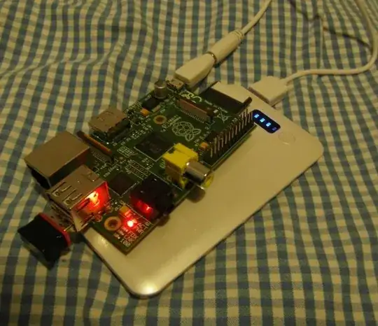

Works now - here is a picture: Raspberry Pi And Battery
Do not know how it will work on low battery, but it works OK now. Here is a link for anyone interested. (Last updated 17/11/2013)
Another update, works very well with a USB camera (was an integrated one removed from an old laptop) and wifi AND ethernet (for downloading) - even when the last blue light is flashing (I got VERY nervous then -but I could not stop it as it was running updates...) confused

(Update 2017) Battery now virtually useless with anything (won't charge properly etc). Be careful of cheap ones ;)
