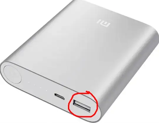

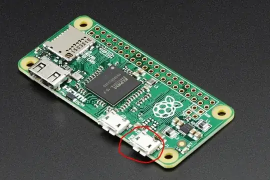

Rechargeable powerbanks are great for this. They are made to recharge mobile phones, so they have standard USB output. I use them in a few of my projects with different Raspberry Pis including the Zero. The size really depends on how long you need it to stay on battery power. For reference, the Zero uses about 200mA max, so if you want it to run for 10 hours, 200 x 10 = 2000mah. But, there is a weird conversion rate due to the batteries within the bank, so always buy more than you need just to be sure.
Some good options:

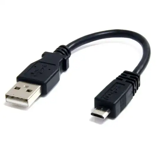

To connect any one of these to your Pi, you would need a standard USB type A to micro USB, like this one here:
Chances are, since you own a Raspberry Pi, you already own a cable like this. Just plug the USB type A side into any of the USB ports on the powerbank.
And the micro USB side into the power in port on the Pi Zero.
Good to go, the Pi should begin to boot once you've plugged it in!

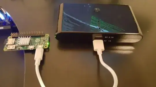

Below is a picture of my Pi Zero, which I power from a 50000mah power bank.
