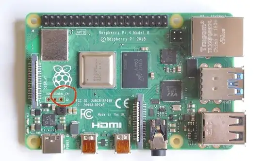

This informs us that the GLOBAL_EN input node may be used in lieu of GPIO 3 to restart the RPi 4 in all possible configurations of these parameters. Three things should be noted re GLOBAL_EN:
  • It is not a GPIO
  • It is pulled up to 5V
  • The actual restart is not* triggered when GLOBAL_EN is pulled LOW by pressing the pushbutton, but when it is "released" and allowed to return to its "pulled-up" (logic HIGH) state.
The GLOBAL_EN node is shown in the photo below:
GLOBAL_EN node location on RPi 4
Summary for Option 2:
This is more difficult than Option 1, but offers the advantage of reduced power consumption in halt/shutdown. The most straightforward hardware implementation is to use two pushbuttons - one for startup, one for shutdown. If you want to take some additional effort, a single button startup & shutdown solution is illustrated here.
