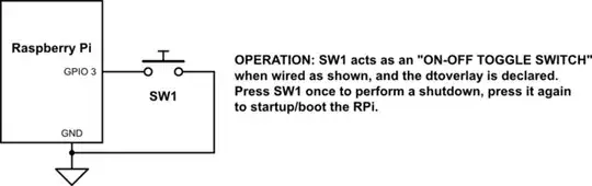

You can use any (most anyway) GPIO if you're only interested in performing a shutdown for the RPi. However, if you want the push button to toggle the RPi between the run and shutdown states you must use GPIO 3.
schematic
No code is required - other than a one-line invocation of a device tree overlay in /boot/config.txt. There's another answer here that has additional details, and some background information on this neat little scheme.
You should also know that the documentation for this (and all other) device tree overlays and parameters is on your local system in /boot/overlays/README. However, this file may be best-accessed via the RPi GitHub page for README as it's always up-to-date.
N.B. When switching the RPi "OFF" in this way, you should know that the RPi continues to draw power. This is why a button press can turn the RPi back "ON" again.
