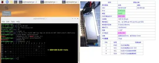

Update 2019dec25hkt2235
I have tested a 0.9" SSD1306 OLED and found "i2cdetect -y 1" can detect the device address 0x3c without any problem. So I guess there are two possibilities:
(1) The OLED modules you bought are bad. You might like to buy or borrow more samples to test again.
(2) Your Rpi buster is not properly configured. As I suggested, you should used another I2C device to make sure your config and i2cdetect -y 1 can indeed detect an I2C device.
I have summarized my test results below. You may like to use similar config and try again (See Appendix B for more details).
ssd1306 oled
Discussion

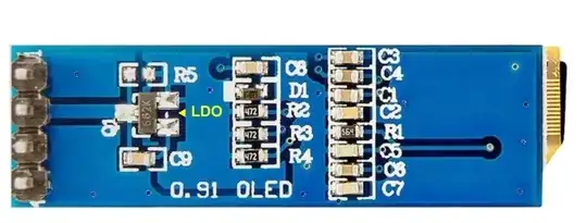

To play safe, I almost always look closely at the PCB for the 3 leg LDO guy (marked 562K below). Errata 2019dec24 - 565K should read 662 K, See Appendix for datasheet.
ldo
My suggestion: Go ahead with 5V0.
Warning: No guarantee no nothing would melt down or blow up.
PS1 - To troubleshoot, you can try any other I2C devices to i2cdetect -y 1 again, to make sure that your Rpi + I2C driver/software etc are updated/upgraded, correctly setup and enabled, and working. Good luck and cheers.
PS2 - The module shows three 4k7s which should be the I2C pullups. There is no need to add your own pullup in this case. On the other hand, if LATER you add more I2C devices and detection is no longer stable, you might consider removing the 4k7 pullups, because Rpi I2C pins already have 1k7 pull ups which are strong enough to do the pull up/down job. (Too many 4k7s in parallel would result a too strong (much lower than even 1k equivalent resistance.) Rpi I2C pins then need to pull harder (Ohm's Law! :))and therefore Rpi would age faster or die sooner. [Pull down current of 3V/1k7 is much smaller than 3V/1k.]

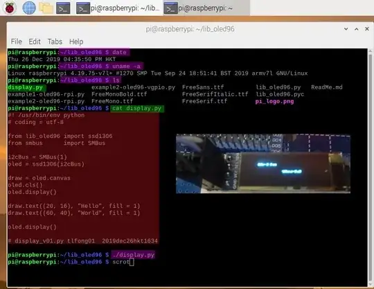

Appendix C - Hello World Program
(11) Rpi: Control I2C SSD1306 OLED 128 × 64 display Python - Sebastian, indibit.de 2018apr16
hello world program 1
