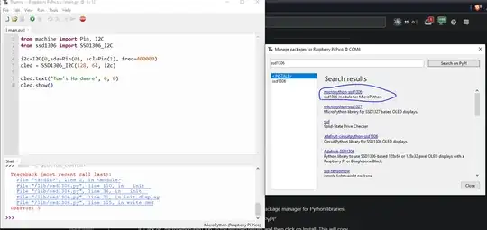

I have .91inch 128x32 pixel oled display. here
im following Tom's Hardware tutorial here
I'm using Thonny on windows 10
ive basically copy and pasted from Tom's hardware
from machine import Pin, I2C
from ssd1306 import SSD1306_I2C
i2c=I2C(0,sda=Pin(0), scl=Pin(1), freq=400000) oled = SSD1306_I2C(128, 64, i2c)
oled.text("Tom's Hardware", 0, 0) oled.show()
I named the file "main.py"
I have the ssd1306 micropython package. when i try to run it i get the following message
  File "<stdin>", line 17, in <module>
  File "/lib/ssd1306.py", line 110, in __init__
  File "/lib/ssd1306.py", line 36, in __init__
  File "/lib/ssd1306.py", line 71, in init_display
  File "/lib/ssd1306.py", line 115, in write_cmd
OSError: 5
I honestly dont know what this is trying to say. i googled "OSError 5" and the only solutions that i could find were to add a delay between the initiation and the first write to the i2c device. that didnt work.
this is an image of the ssd1306 that i chose in thonny
does anyone know how to fix this error?
thank you.
SOLVED: it has been some time since i posted this question,, but this is what i found. errno5 means that the pico couldnt see the oled on the i2c interface. my oled was broken. i can no longer use the module manager for the ssd1306 library, but i could just include one i found online. I dont remember exactly the library that i looked up, but if asked, i can share the file.

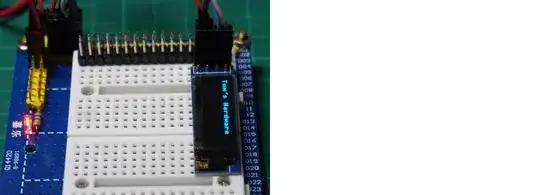

Update 2021apr08hkt1233
I found the 0.91" OLED a bit tricky to detect. I need to make the the wiring short, not to load two or more devices. I also found I2C Bus 1 better than Bus 1. Anyway, I used Tom's Hardware's short program and found it OK, though not stable.

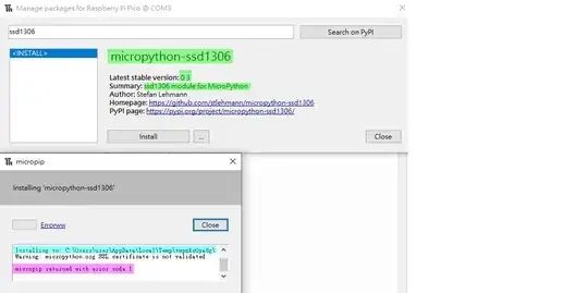

  1. Click on Tools > Manage Packages to open Thonny’s package manager for Python libraries.
  2. Type “ssd1306” in the search bar and click “Search on PyPI”.
  3. Click on “micropython-ssd1306” in the returned results and then click on Install. This will copy the library to a folder, lib on the Pico.
  4. Click Close to return to the main interface.
Note - Only partial installed, with error code 1
ssd1306 install error 1
Update 2021apr03hkt1528
I installed ssd1308 second time and had good luck.
ssd1306 install ok
