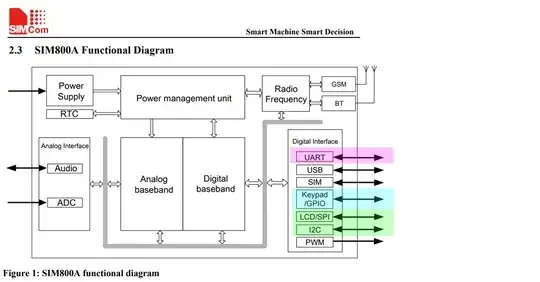

(1) Introduction and Functional Block Diagram
First thing first, let us look at the functional block diagram, and make sure we know which "function" we are messing around. It is吖good idea to start with the simplest thing first, in our case, UART. Forget for now the newbie scary things I2C, SPI! :)
sim800 block diagram

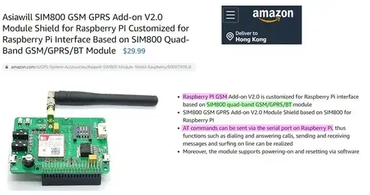

(2) How can Rpi send AT serial commands to SIM800?
I read that SIM800 can talk with Rpi using serial AT commands. So perhaps we can start looking at the UART setup and any Hello World AT command shall we use.

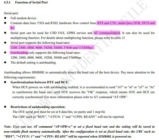

(3) SIM800 Serial Communication Specification
Now I am read the manual to see how SIM800 serial looks like. It seems that SIM800 can do auto baudrate detect. In other words, if Rpi is set to No Parity, 1 stop bit (8N1) any speed, SIM800 should at power up, detect Rpi 9600 N81 "AT" command and responds with something like "OK" (See Ref 6).

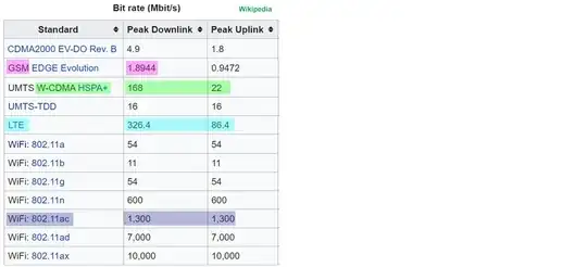

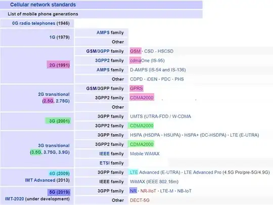

(5) Very Slow 2G/GSM/GPRS, or fast 3G/4G/LTE, or super fast 5G/NR?
The OP asks if he should buy a new card. My immediate comment is that if he has already bought the old SIM800 GSM/GPRS card, he should at least try it and learn the basic things. But then afterwards, he might like to consider the newer 4G/LTE modules, or like me, wait until 5G coming to town. I guess 4G/LTE/5G modules should also use the good old UART serial AT commands, so the tricks discussed here should still be useful in 5G times.
