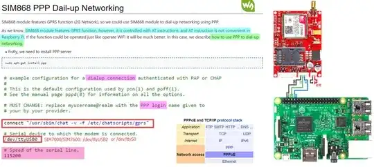

  • For internet - followed https://www.waveshare.com/wiki/SIM868_PPP_Dail-up_Networking this and able to connect internet (ttyUSB0 was used)> But the connection is very slow (always ping succeeded) I was not able to activate the 3G connection though I update with APN of the service provider.

Well, the user guide already explained why Rpi is slow. They fiddled something but using 115k baud AT command to do PPPoE is of course slow. The service provider might also set lower priority to poor 2G customers

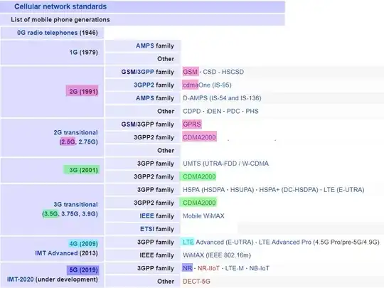

Your board is only 2G GSM/GPRS. So you can not do 3G. Bad luck! :(

List of mobile phone generations
