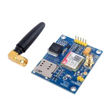

This is my GSM Module:
Is anyone familiar on how to connect this to my Raspberry Pi 3? Is still all I need or I have something missing?

This looks like the SIM800 GSM chip. This needs to be connected to the serial port (UART) on the Raspberry Pi (make sure that the voltage levels on the SIM 800 and RPi pins are the same or you'll end up bricking either or both the devices).
Once that is done, you will have to use the "AT Commands" to write a program that communicates with the SIM800 over serial. Here's an AT command reference manual - https://www.elecrow.com/wiki/images/2/20/SIM800_Series_AT_Command_Manual_V1.09.pdf

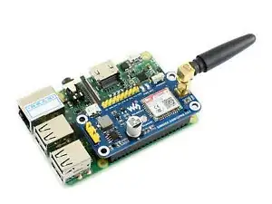

Have you considered a GSM HAT? It will be faster, easier and less damage risk to your pi. The final product will also be neatly stacked.
If your rPi has internet access, then you could try an internet SMS gateway (Twilio etc.) and skip the GSM radio
